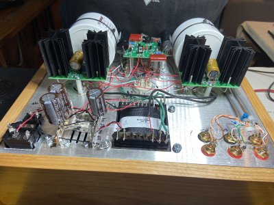

I built the Crackatwoa and listened for a day. It was outstanding and great fun to build, of course. I also changed out the caps and listened some more. Today I installed the Twoquiet along with some bigger caps. Once I completed the Twoquiet upgrade I ran the resistance checks and all passed (still do). I then registered the following voltages:

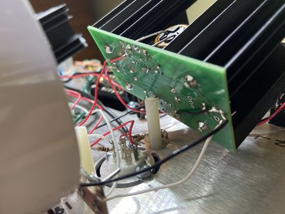

The other higher current board measures perfectly. After going through the manual twice, I focused on the bad high current board. I removed the jumpers and all excess solder/flux. I took my time and reflowed all pads and ran new jumpers. I also inspected, checked for continuity/resistance all connections on the B tube socket as well as solder lugs 6-10.

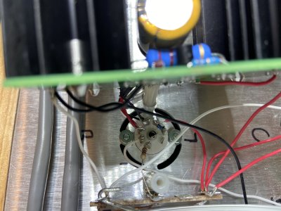

I reflowed the A side of the low current board and ensured all connections were clean around terminals 1-5 and 11-15.  I even reattached the white wire on pin 2 of the 7-pin socket under the offending board. I swapped the 7-pin tubes and am still getting these second set of voltages from my OP. Is there some way to rule out a bad transistor?  I suppose I could swap the high current boards, and if the issue doesn’t follow the board then I must be missing a mis-wire or short.

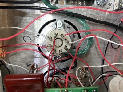

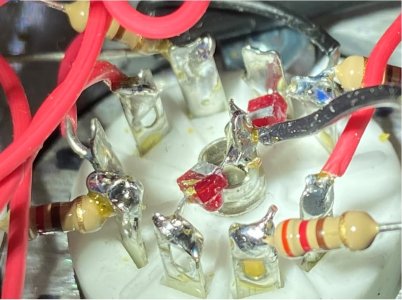

My concern regarding the solder comes from your photos. There's light colored flux gooped all over everything.  That's not the color I would expect from rosin core flux and seeing it just all over the place is inconsistent with the flux flowing out form inside the solder.
On the high current C4S board, disconnect the wire leaving OA and going down to the 5 lug terminal strip below it, then see if OA on the high current C4S board pops up into range.

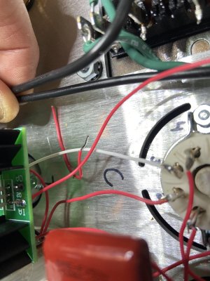

Well, I desoldered the wire leaving OA on the HC board by gently pulling down with tweezers, and wouldn't you know, the short wire fell to the chassis as it broke off from the 5-lug terminal strip.  This seems likely to be the root cause, if this wire has become compromised!  It passed my basic continuity checks but it was obviously extremely week.  I'll rework that connection and post my results.
Thank you for leading me directly down the (or a)correct path!
BTW, that flux certainly looks disastrous on the A tube base, but that was the only photo I used a flashlight to assist with lighting.  That clear/blue haze is a weird reflection from the flashlight and really just a shiny bulb of solder.  The yellow/gold splatter is all me using too much solder I suppose.

While she was running yesterday I noticed that the chassis plate was much warmer than the Mainline  or BeePre2. Not alarmingly so, but I though it worth mentioning.  I figured it was due to tight fitting ceramic tube sockets.

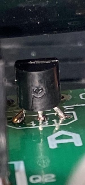

Reply #12 on: May 23, 2021, 06:00:16 PM
That would tend to point to a shorted TL431 on the center low current C4S board.
Offline Toobuzz
    • Posts: 72
Reply #13 on: May 23, 2021, 06:25:33 PM

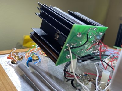

Ok, excellent!  What can I do with this?  This doesn't look shorted to me, or am I missing something?
« Last Edit: May 23, 2021, 06:51:50 PM by Toobuzz »
Reply #14 on: May 23, 2021, 07:04:07 PM
I would recommend removing it and replacing it.  You can't just look at it and say with certainty that it's shorted.
