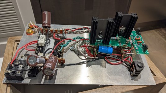

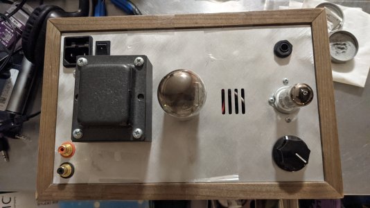

Can you post some photos of what you got?

Thanks for replying! Please let me know if you need more photos.
    • Posts: 20286
That's a Crack 1.1.
On the 5 lug strip mounted by the 9 pin socket, the outer pair of terminals should measure around 75V DC with the amp running, the inner pair of terminals should be around 175V DC with the amp running, and the middle terminal sits at 0V.
On the 5 lug strip mounted to the octal socket, the outer terminals should be 0V, the inner pair of terminals will be roughly 100V, and the middle terminal 0V.
This is about all of the information that you would get out of the manuals.  You're also missing the fuse holder, but the fuse looks to be installed at least.

Did you get this amp sorted out? Looking at the pics I'm not seeing solder on the resistors on the speedball circuit boards. If I were you I'd re-solder ever joint on the amp.

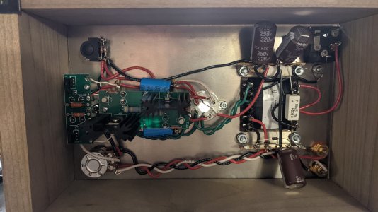

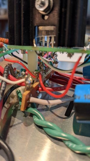

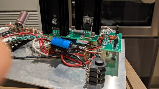

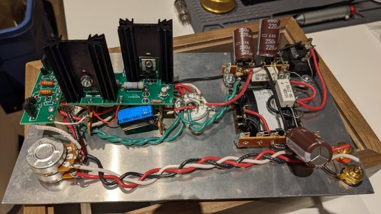

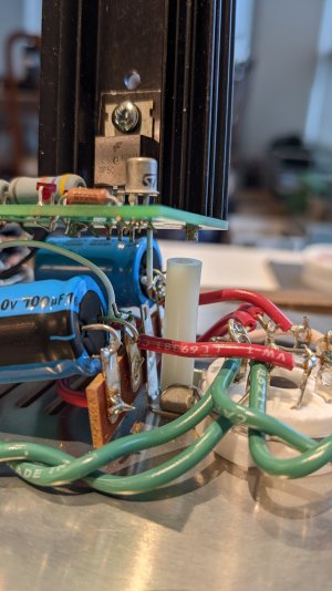

Can you post a photo of the underside of your amp?
Offline manicmidget
    • Posts: 19
Reply #10 on: November 27, 2022, 05:05:48 PM

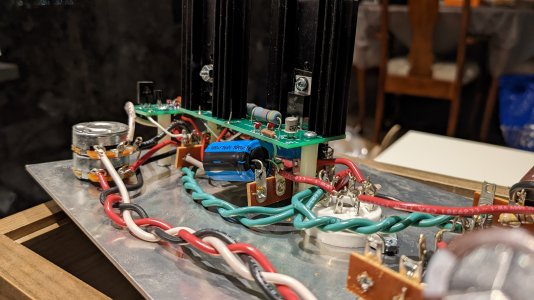

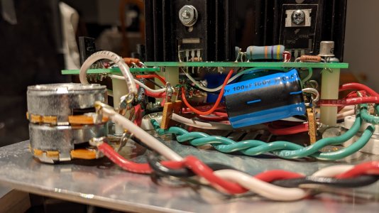

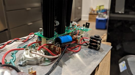

Thanks for the super quick reply! I tried to do my best with camera angles. Please let me know if you need more photos.
Hi, sorry for taking so incredibly long to respond. The resistors are indeed soldered, just on the underside.
    • Posts: 20286
Reply #12 on: November 27, 2022, 06:59:28 PM
one of the inner pair reads ~110V and the other ~0V, and there's nothing soldered to the centre pin.
The inner terminals on the 5 lug terminal strip are attached with a piece of wire.  They can't have different voltage readings between the two like that unless that piece of wire is broken or poorly soldered.
I see a lot of untrimmed leads on the C4S boards.
It's incredibly common with weird issues like this to find that one of the black wires going to the headphone jack isn't captured by solder.
Offline manicmidget
    • Posts: 19
Reply #13 on: November 28, 2022, 09:36:18 AM
First off, I'm sure you already know, but it looks like I got the sockets mixed up.
There's a wire between the inner pair for the 9-pin lug strip, but not for the 8-pin (the one with the mismatched voltage) -- see photos. I assume they should both have their inner pair connected?
Continued thanks!
« Last Edit: November 28, 2022, 09:45:33 AM by manicmidget »

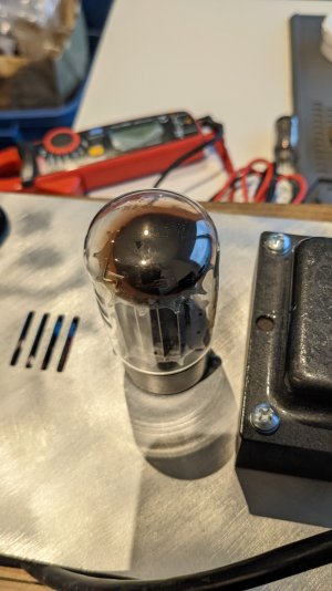

Is it possible the tube is burned out?
