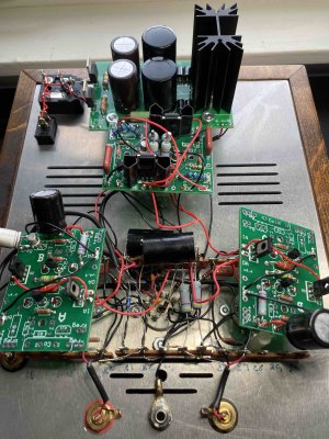

Pictures!

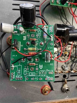

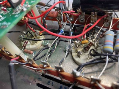

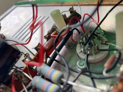

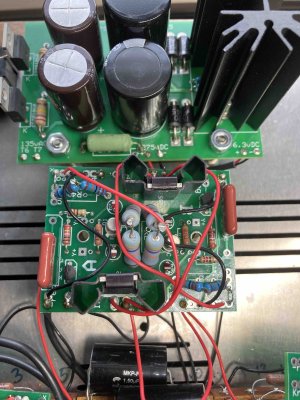

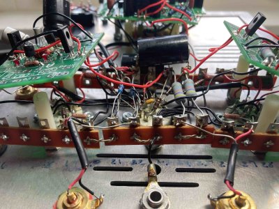

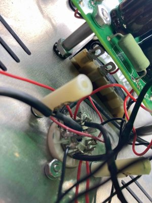

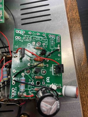

Here you go. Let me know if you see anything suspect. Thanks again.
    • Posts: 20348
Reply #5 on: July 07, 2021, 11:14:46 AM
The area around pin B8 looks concerning.

Reply #13 on: July 08, 2021, 09:24:54 AM
Those resistances and the consistency of voltages points to an issue with the C4S board on the B channel.  You can set your meter to beep when you touch the probes together, then see if any pair of legs on the MJE350 or MPS420 shows a dead short.  You may well just have a shorted transistor.
