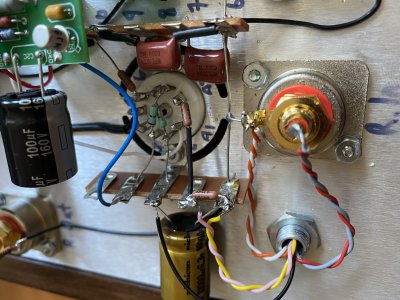

I have attached a photo of one of the SUT installs.  Can provide more photos if issue elsewhere in the Eros is suspected though I was ruling this out due to it being an issue with my previous phono stage.

SUTs are susceptible to hum induced by magnetic fields. That's why the Eros has a power transformer with a very low radiated flux. It is possible that your SUTs are being affected by some other power transformer in your system that is relatively nearby, or perhaps the AC motor in your turntable. I found that I needed to move my outboard SUTs around on the shelf to find a quiet spot in our old room. You may want to try moving the Eros around to see if you can find a spot where the hum is reduced.

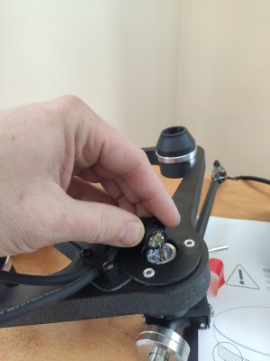

I just dealt with this on a Planar 8 earlier this year, and you're not going to like the answer...
Normally what we want with a tonearm is the metal tube of the tonearm to act like a shield, and for this shield to continue as a shield wrapped around the interconnects as well (braid or foil) which terminates at an earth lug on the phono preamp.  Then the signal wires come off the cartridge and run as twisted pairs all the way down to the RCA jacks. This is super useful for a moving coil cartridge especially since you can use step-up transformers and the signal wires and shield wires aren't connected.
Rega completely botched this to be honest.  Their phono interconnects aren't shielded at all which is a little alarming.  Then they take the earth drain wire from the tonearm and just send it down the signal cold of the left RCA cable.  This injects noise into the signal path, which isn't helpful.
What I had to do on the P8 was to pop the rubber plug off the bottom of the tonearm, then it's clear where the black and blue wires are soldered together.  What you want to do is to gouge out the trace between where the blue wire mounts and where the copper earthing tang solders to the board, then move the black wire over to that connection to separate the left signal cold from the shield (the blue wire stays put).  Now that you've done this, loosen one mounting screw on the tonearm and wrap a wire around it, then tighten it down and run that wire to the earth lug on the Eros. I was prepared to also need to slip some braided shield over the RCA cables to provide some extra shielding, but everything worked nicely when I got to this point.  Be sure to pull the platter and get the ball bearing out before taking on this work, as I had to chase down a tiny ball bearing in a giant rug in a very fancy house when I did this and my customer wasn't super impressed.
This is all so ridiculous that I took a picture of the plug for future reference.  You could also switch to a moving magnet cartridge and no SUTs as well.

I would tighten down all of the screws in your kit.
    • Posts: 9780
Reply #13 on: July 14, 2021, 01:11:11 PM
Yup, tighten everything up. You might also try running a wire from the Eros ground post to the chassis of the Naim preamp and see what happens.

Everything seemed fairly tightened down but I decided to reinstall the SUTs.
I had a nut either side of the chassis so that the toothed washer was between SUT and nut.
Now have washer between SUT and chassis, 2 nuts under the chassis.
I also moved the SUT ground wire direct to signal ground (though as far as I can tell this is connected to chassis anyway)
Anyway, hum is still there but does seem quieter. Not so intrusive in the gaps. Sowter website does say may need to experiment with different grounding locations to eliminate hum.
