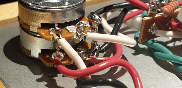

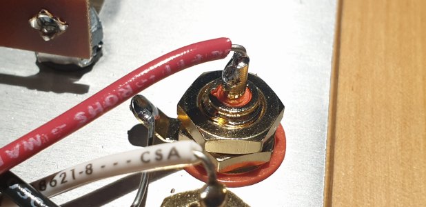

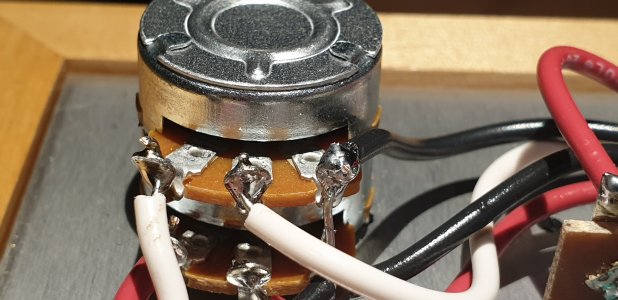

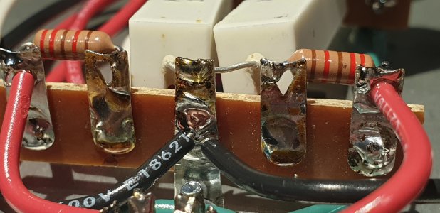

Reply #3 on: July 17, 2021, 11:56:05 PM

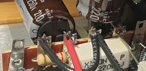

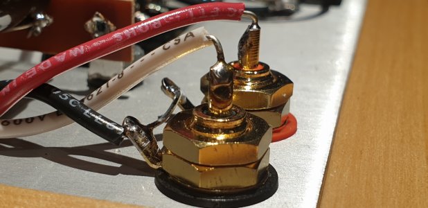

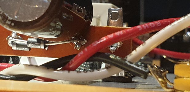

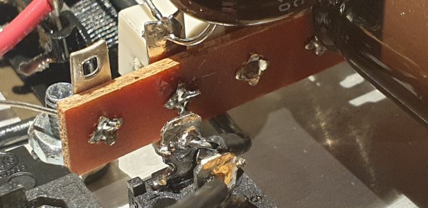

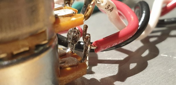

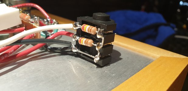

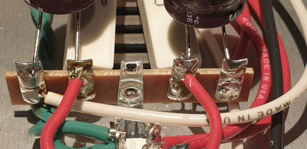

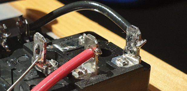

Hi Paul, here you go, I'd like to add the soldering looked much better the first time around  :'(

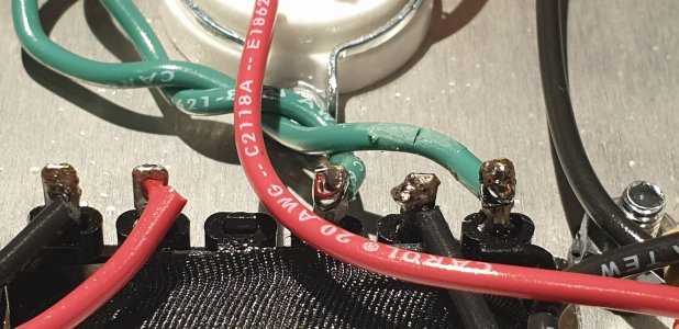

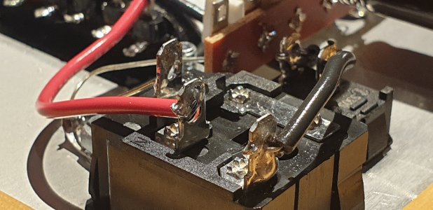

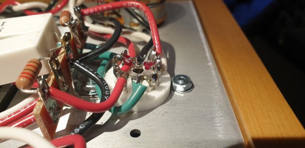

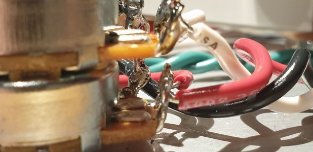

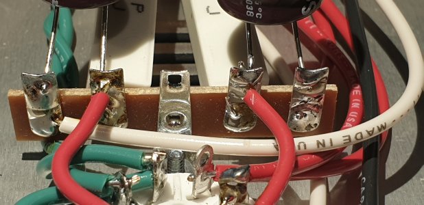

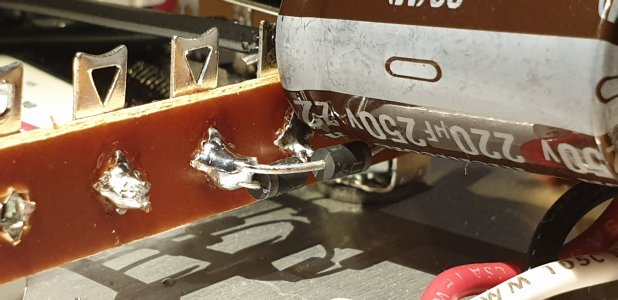

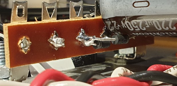

Offline fung.chan
    • Posts: 9

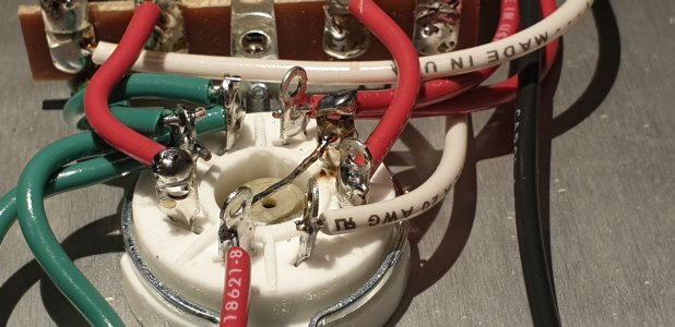

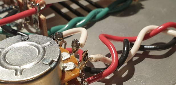

Reply #4 on: July 17, 2021, 11:58:22 PM
Continued

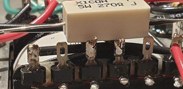

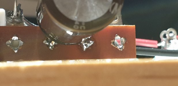

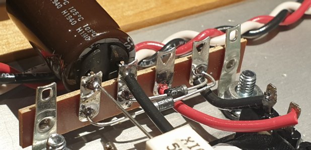

Offline fung.chan

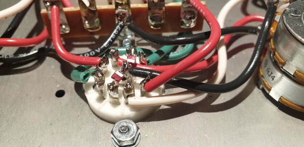

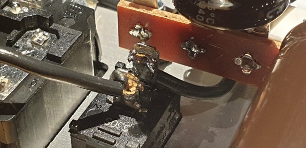

    • Posts: 9
Reply #5 on: July 17, 2021, 11:59:49 PM
Continued
    • Posts: 20295
Reply #6 on: July 18, 2021, 04:53:09 AM

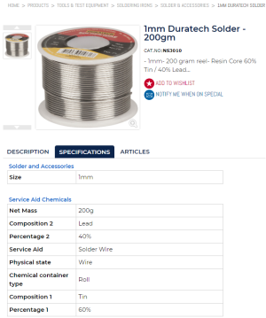

What kind of solder are you using?
Offline fung.chan
    • Posts: 9
Reply #7 on: July 18, 2021, 05:13:37 AM
Hi,
Duratech 1mm 60% SN, 40%PB, 2% Flux 2%, resin core.
