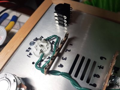

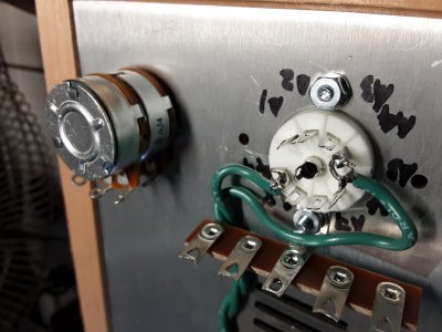

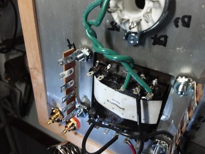

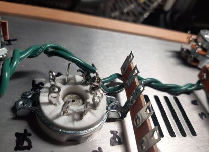

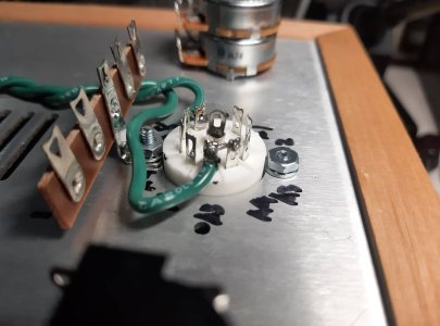

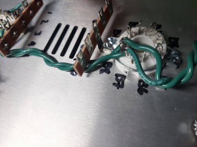

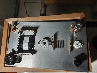

Hi guys just want to share some pics to ask if im doing the assembly right?

There are oodles of common hardware mistakes that are pretty common, but I don't see any in your photo.

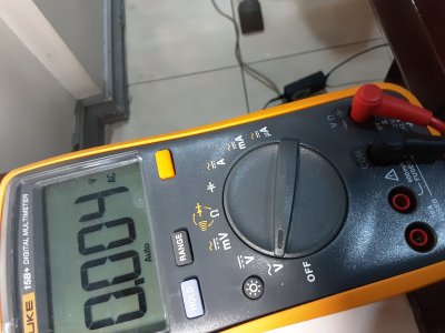

To what setting should i set my multi meter to when measuring what voltage i need for the transformer and resistance? Attached is an image of my meter..

The image didn’t attach.
