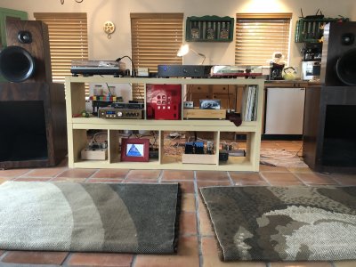

Running the MonAmour on the right Edgarhorn and one of my two S.E.X. amp bi-amping the left Edgarhorn and using the gain control on the S.E.X. amp for balance.
Running just one or the other it is quite obvious that the MonAmour is a BIG step up from the Paramour (which I first heard near 20 years ago and was $500?).

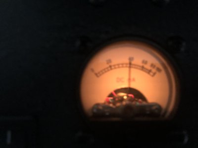

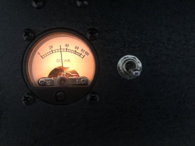

Meter shows about 30 with the switch in the 'forward' (toward the front) position and maybe 40+ in the 'rear' position.  Currently running a pair of TJ/Full Music 2.5V 300Bs (Sovtec 2A3 on B/O, not a problem) and can hear NO difference between switch positions.  Willing to take some measurements with a meter but I sure think the cathode resistors are wired correctly and as the cathode current goes THROUGH the three parallel resistors on the meter if it's making music it must be wired close to correctly???  Switch seems to short out the smaller sand cast resistor?

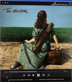

And yes, gotta play some audiophile stuff.

The Hunter is a great album and an excellent recording.

Voltages:
2A3 Pin 2 380V
Pin 1 Switch to front 65.5V
Pin 1 Switch to the rear 61V
Meter pics below, both positions, switch forward about 32 and switch to rear about 40?
Bias voltages OK?
Meter not so good?
Last night after being on for about 4 hours, meter died altogether.  Works as above on the bench this morning.

Reply #5 on: August 02, 2021, 05:20:11 AM
If you can get the meter to the point where the needle drops, give it a very, very hard whack with your knuckle.  I have about 1 in 25 of these meters that I have used where the needle will drop to zero, then giving it a really hard wrap will usually bring it back to proper operation indefinitely.

Reply #7 on: August 02, 2021, 07:03:34 AM
Yes, those look OK.
