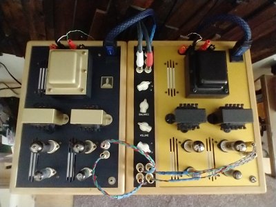

Looking at the instructions for wiring the output for mono on page 38 (with an eye towards reverting back to stereo if the mood strikes in the future) would running a wire directly from the ground tab to the black post of the right output work equally well? My thinking is that the wire running from the ground tab to the red post of the left output could simply be clipped, stripped and attached to the black post of the left output for stereo operation.
Also, is my single speaker wiring correct in the photo?

Reply #1 on: August 26, 2021, 05:33:22 AM
That shouldn't be a problem if you do it that way.  Do you have two Seductors?

Reply #6 on: October 01, 2021, 05:59:57 AM
Got the Seductors up and running as mono-blocks. (OTs wired for 4 Ohm until the new bits have time to burn in, then some experimentation may begin)
My passive switching / volume / balance control panel is wired so that one of the outputs bypasses the volume / balance pots. The plan is to put the Quickie between the phono stage and the control panel and use the Quickie's volume / balance when listening to vinyl.
Thanks to everyone at BH for another fun project,

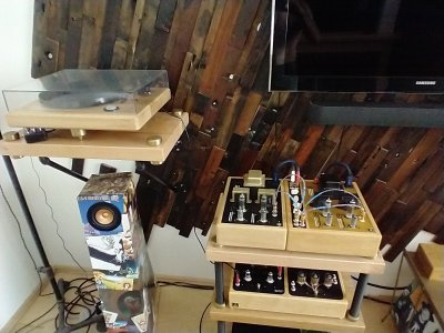

Offline Thermioniclife
    • Posts: 815
Reply #7 on: January 22, 2022, 08:05:35 AM
Excellent work well done. It gives me food for thought. Thanks. Are those Frugel Horn Mk 3's ?
    • Posts: 634
Reply #8 on: January 24, 2022, 03:19:45 AM
Thanks Lee,
Yes, FH3s with MA Alpair 7.3s. Pretty amazing (horn) bass from some little 3-1/2" drivers.
