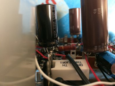

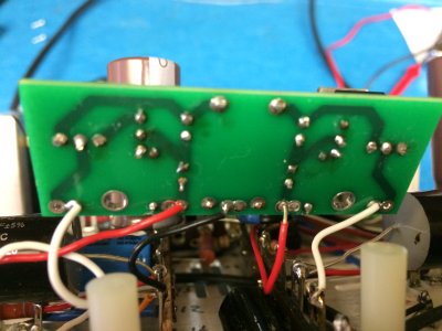

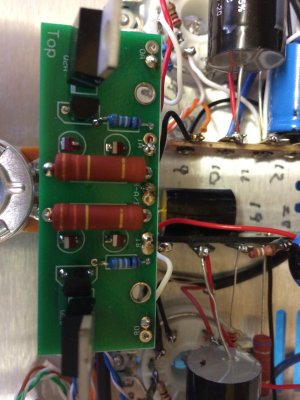

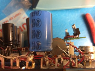

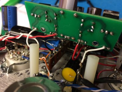

Reply #2 on: October 10, 2021, 09:34:09 AM
Here are some pictures.
    • Posts: 20204
Reply #3 on: October 10, 2021, 10:42:23 AM
You have a backwards transistor.

Okay, where is it?

Reply #6 on: October 10, 2021, 12:11:33 PM
Okay, I see it now. How does one go about desoldering that? The Board came to me already built.
