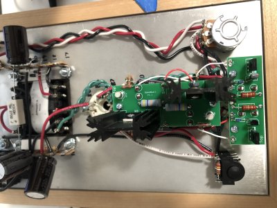

Hello,
I finished the base crack a month ago and it has sounded great without any problems.
I started the speedball upgrade today.
I finished the small board and all the resistance and voltage tests passed. I listened to it with my headphones and they sounded great.
I finished the large board and all the resistance and voltage tests passed. The resistance tests both had a value of over limit no matter what ohm adjustment I used on my multimeter.
I'm not sure how this happened but after I finished the tests, I flipped the panel over to start listening to it and as I turned it on, the 6080 loudly crackled and burnt out.
During the final test, I didn't hear anything odd while I turned it on. I also saw that both tubes were glowing before performing the voltage test without any problems.
Really not sure how flipping the panel over could have caused such a massive problem.
The fuse is still intact. I checked all my connections already and everything looks correct. No bare wires are crossing from what I could see.
I'm really not sure what to do now :(. With the 6080 bulb blown, it seems really difficult for me to figure out a solution in a timely manner.
Any help/guidance would be appreciated.

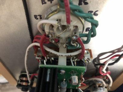

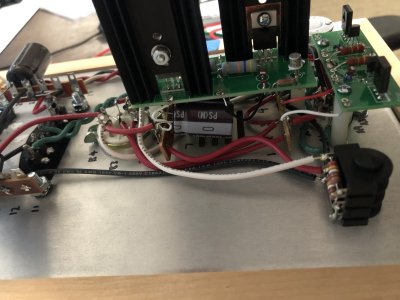

Offline AB2KH
    • Posts: 47
Reply #7 on: October 11, 2021, 08:26:49 AM
Tom,
I would not use your amp. It sounds as though you still have a problem. Remember there are HIGH voltages and currents present in vacuum tube circuits that demand respect, believe me I have come VERY,VERY close to meeting my maker tinkering with this stuff.
My observations
1 mounting hardware transistor/heat sink ?
2 B+ connection at 6080 tube socket ?
3 B+ touching heat sink?
 Electronic circuits DO NOT magically fix them self.
 Chris/AB2KH
« Last Edit: October 11, 2021, 08:35:38 AM by AB2KH »

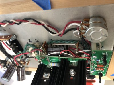

    • Posts: 20302
Reply #9 on: October 11, 2021, 09:37:15 AM
The IA wire on the small PC board also doesn't look to be well soldered.

Reply #10 on: October 11, 2021, 11:44:23 AM
I've since:
Reheated all the joints on the large board
Reheated all the wiring connecting to the large board and added solder where I saw fit
Added more solder on IA
Adjusted placement of wires so they were farther apart
Shook it really hard to get rid of any debris
Volt Test:
Small Board
OA     69.8
IA     176.3
B-A/B     0.2
IB     175.9
OB     72.6
Large Board
OA     100.6
OB     97.4
G     0.2
B+     176.2
Resistance Test:
Large Board
OB     Over Limit
OA     Over Limit
All LEDs were lit
The 6080 bulb was originally creating a spark on start up with a quiet 'click' noise.
After doing the aforementioned changes, the spark within the 6080 on start up has turned into a tiny inaudible twinkle, but a larger audible spark sometimes still occurs, but also sometimes neither a spark or 'click' occurs.
As far as I can tell, music through the headphones sound normal without any distortions.
I recorded the before and after videos of the 6080 tube if anyone would like to see it.
« Last Edit: October 11, 2021, 11:54:27 AM by Tom H »
