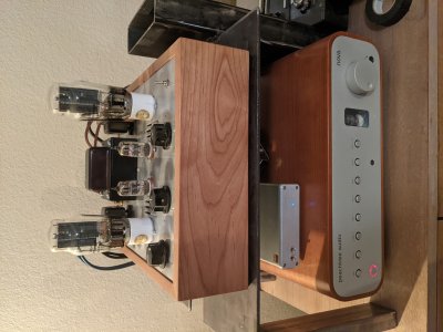

Just finished piecing together a stereomour II, my first SET amp and my new reason to never leave the house :)

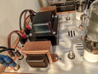

I've included some photos because I'm super proud. I had some discipline with the paint job which I think paid off. Also - I read all this stuff about "bluing" for the PT bell. I didn't have any bluing solution, but I did have acetone and a torch - got a gorgeous rainbow effect which I preserved with some clear enamel rustoleum. I definitely recommend trying that out - just be careful the thin metal doesn't warp. I wonder if that would work on the chassis plate?

The flame bluing is very nice. Never thought to do that on a transformer bell, but I have done watch hands that way. To answer your question - nope, the aluminum chassis panel will not blue with heat.

Doc- thanks for the kind words about the flame bluing and good idea for watch hands.. haha thanks for pointing out the chassis panel is aluminum, good thing I didn't try it :)
