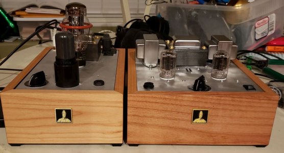

I started my S3X build 6 days ago and I am happy to report that I am done with the electronics and just have to oil the base and apply badge. All voltage and resistance numbers checked out fine. Everything is working GREAT wired at 4 ohms; HE6se and DT1990 Pro driven very well, plenty loud.
The manual is superbly written. NO INFORMATION is missing. NO parts were missing. During the build I was thinking how incredibly lucky I am to get the opportunity to build such a high quality amplifier. The price, the experience, the support, the feeling of accomplishment. I can't thank Bottllehead enough, it's really quite an experience to arrive at the end of a build. I have done a fair amount of soldering but do not consider myself an expert. The S3X build was slightly more challenging than I anticipated. The best advice was "NO Prize for finishing quickly" and heeding it it paid off big time.
When I finished, I compared it to my Crack build and didn't realize how little guts the Crack has. The S3X is a beast of an amp. In all fairness they are both awesome performers.

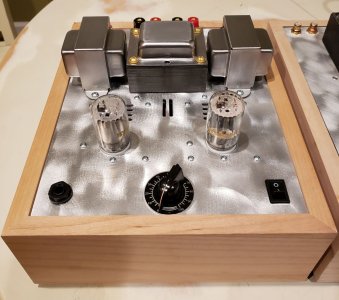

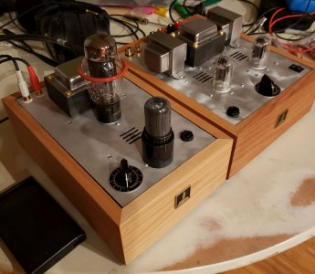

I forgot how beautiful alder wood is and the S3X looked so good after I finished, I decided to sand the paint off of my Crack base and return it to bare wood. I feel dumb for putting paint over this stunning wood grain. Anyway liking it better now and I also like the bare metal silver metal look. I sanded both the bell and the chokes. Those chokes took quite a bit of work to get all the protective varnish off. Once removed, all of it was polished with Mothers Mag aluminum paste. I really like the brushed look and the end result.

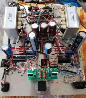

I did have an issue with the left side tube not lighting and it turned out to be a broken red wire on the A12 socket pin. It passed the glow test earlier but no-go at the voltage check. The manual said to look at the wiring going to the B side and sure enough I found it but it was a bit more elusive because I had continuity from a side to b side. After enough poking around it finally just broke away from the pin. That was a relief seeing that as I knew I found the issue. Probably a bad wire strip???
I have NO plans to modify the parts or wire as I REALLY like what I am hearing. The only component of my own that I used was an Audio Note volume pot which has a really nice resistive, smooth feeling to it. I am not sure it sounds any better than the Alps pots I've used, but it is working very well.
Anyway, sorry for being long winded. I am ecstatic with the amplifier. Building the kit is very satisfying and like the Crack, I will never get rid of it. There are two things IMO with Bottlehead kits that are a must. Build your own kit or learn to build it, AND never get rid of it unless absolutely necessary. Thanks so much for a great experience that will last my lifetime ..............

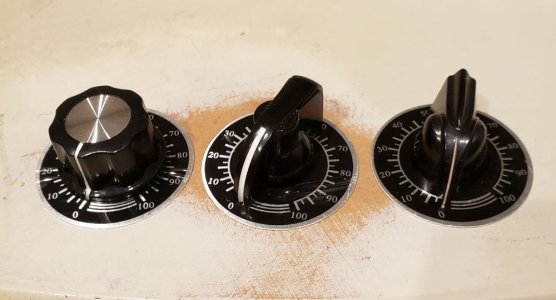

Much better than the Chinese knockoffs. Better, thinner lines and curves. And they fit perfectly size wise on the dials. The 0 and 100 are perfectly aligned with the knob too which is really cool. It's actually accurate! I did have to trim my pot shaft with a Dremel so the knob had perfect space in between it and the dial. I also added a washer on the interior. It was a bit of work but well worth the effort to get it perfect.
The picture shows the knob and dial kit from amazon ... pretty nice IMO, the chinese knockoff knob in the middle and the Daka on the right. As usual, they had it right back in the day ......

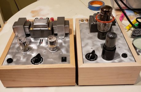

Amp is completely finished. Danish Oil and badge applied. Really looks incredible if I do say so. And stripping the paint of of Crack gave it a fresh new look. Changed out the transformer bolts to brass one's to match the S3X. Crack for my Beyer's and S3X for my HE6se. Good stuffs ..... thanks again BH!
