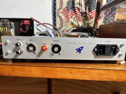

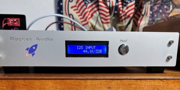

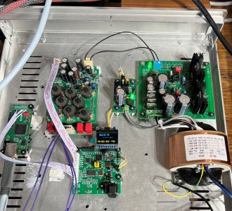

Here is a picture of the set up and the finished unit

Hi Debra, I have now built an AMB labs Sigma 11 board and I am going to order the R-core transformer. Is the transformer shown in these pictures the R-core? Also it shows 12V/12V and 9V/9V. Would a 12V/12V  12V/12V work as well? My power supply for the SPDIF board needs from 5 to 12V.  Also, can you tell me your source and part number for the USB input board that says 6631PRO? I appreciate your support.
« Last Edit: April 01, 2022, 09:38:42 AM by Tubegopher »
Offline debk
    • Posts: 658
Reply #14 on: April 01, 2022, 11:08:29 PM
Yes, I used an R-core transformer.  If you are powering the Phi Deca Dac I believe it needs 12-15 volts.  check the documentation on the the DIYauudio thread.  You will have to look at the AMB sigma 11 documentation to determine what transformer you would use.  If you can power all the boards at the same voltage then you can the multiple outputs from the Sigma 11.  I chose to have a 24 V supply and a 5V supply for the Celibidache DAC plus input board  With the Phi Deca Dac work at a lower supply voltage.  I bought the input boards when I bought the DAC kit.  Any USB to I2S should work.  the boards are available on eBay and Ali Express
