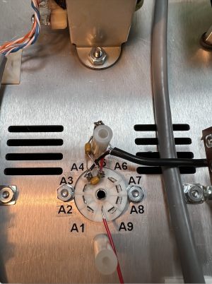

I am not sure I made the correct soldering.
On page 71&72 of the Mainline manual it says (ref. picture #1 att.) :
-"Bend the leads of a 0.1μF 100V capacitor close to the body of the capacitor. Attach and solder the leads to C4 and C5."
-"Bend the leads of a 0.1μF 100V capacitor close to the body of the capacitor. Attach and solder the leads to A4 and A5."

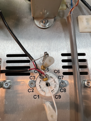

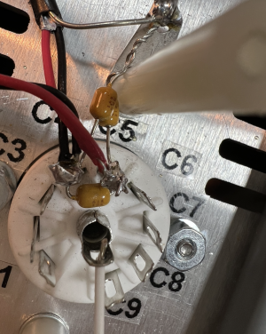

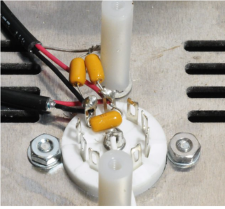

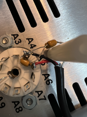

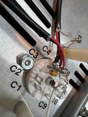

On both instances I soldered the two leads of the 0.1μF 100V to C4 and C5 / A4 and A5 respectively (ref. pictures #2, #3, #4, #5 #6 and #7 att.).
Was soldering all of them together the way to proceed?
Thank you in advance for the help.

Looks OK to me. You can power up the amp with the tubes in to be sure they glow if you'd like.
