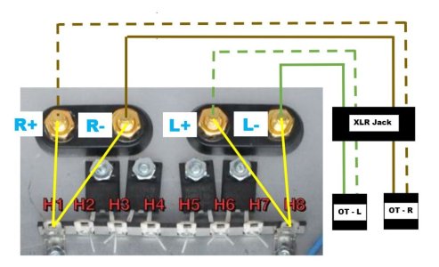

I attached a photo. So essentially the steps are?:
1. Replace the jack
2. Route all the same colored wires from the speaker taps and OT's to their 4 respective solder pots on the XLR jack
3. Remove the two zero resistors
4. Install 4 resistors as follows (yellow lines in photo)
200 ohm resistor from R+ to H1
200 ohm resistor from R- to H1
200 ohm resistor from L+ to H8
200 ohm resistor from L- to H8
Does that sound correct?

    • Posts: 20286
Reply #5 on: December 23, 2021, 03:50:48 PM
Give it a shot!

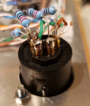

I am now thinking of just taking the TRS jack out and placing the Neutrik there with the OT's wired to it. Then, I will leave the speaker wiring in place but not connected.
A I understand, all I will have to do is solder the 4 resistors from each of the 4 XLR pins to the ground lug on the Neutrik jack which I am assuming will be grounded to the plate once installed. Is that correct?

    • Posts: 20286
Reply #8 on: December 26, 2021, 11:56:05 AM
Sure, that will work as well.  The earth lug on the XLR jack is usually not all that substantial, so it may take some extra effort to get four resistors connected to it.

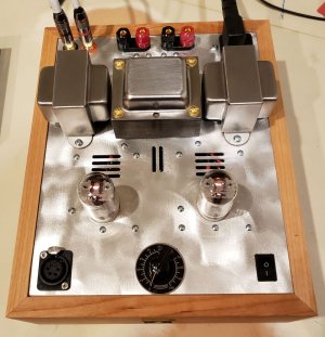

Reply #10 on: January 04, 2022, 09:42:21 PM
I was able to get the Neutrik jack installed tonight. I also modified my DT-1990 Pro and 1770 Pro from 3 pin XLR to 4 pin XLR.
I am super thrilled with the S3X amp with my newly installed XLR jack. The 1990's and HE6se are working great with balanced cables. Will be using Grado RS2e, PS500, Denon AH-D5000, HiFiman Sudara, HE5se ..... all terminated with 4 pin XLR plugs .... good stuffs!
Thanks for the help Paul!

Reply #11 on: March 27, 2022, 01:59:23 PM
Hello PB,
I have a question for you (if you don't mind). I have been looking at adding an XLR jack to my Crack and how to do it concerning grounding. And that led me to how I did the jack on the S3X (shown in the previous posts in this thread).
With the S3X XLR jack, I have a resistor from all 4 pins to the grounding lug on the Neutrik XLR jack which is grounded to the chassis.
Would it be better to route the grounding directly, to say, H1? It would be easy to add an insulated solder turret near the jack, run the resistors from all 4 pins to the turret and then a black wire from the turret to H1. As I understand that will put the signal ground very close to the IEC ground and possibly help with transients???
Or would it be a waste of time? Thank you!
« Last Edit: March 27, 2022, 02:01:41 PM by Mucker »

Reply #12 on: March 27, 2022, 02:35:01 PM
The SEX grounding on an XLR jack is not an accurate representation of what would need to be done on a Crack.  You would ground pins 2 and 4 on the XLR jack to the audio ground in the Crack.

Reply #13 on: March 27, 2022, 02:42:57 PM
Roger that, thank you. So 2 and 4 to terminal 3  on Crack?
For S3X would it be better to move the grounding from the jack lug and go directly to H1 with a wire? Essentially taking the pin resistors directly to H1?
    • Posts: 20286
Reply #14 on: March 28, 2022, 04:39:28 AM
That is not necessary.  The resistors just form a reference to ground to balance the output and this is far more convenient to do on the grounding lug provided on the jack.
