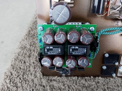

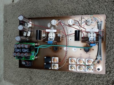

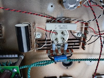

Here are a couple of pictures.  I am hoping for permission to hook this thing up and gather more information but will absolutely follow your instructions.  And I think you work too hard.  My problem is not urgent.
