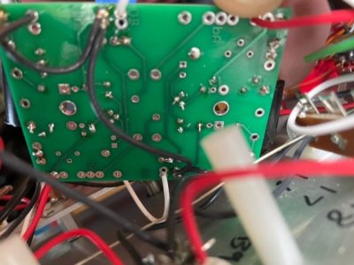

attaching a pic of the board where kreg is measured.

Did you fold the leads of the little blue pot over as shown in the instructions? What are the OA and OB readings on the center PC board?

OA is 5.23 and OB is 5.55. And it looks like I did fold the lead (picture attached).

I re did the solder at the fold just to be safe, and got same result. Which is - I still cannot change the bias which seems to be stuck around 215 volts.
I am getting 215 DC volts on both terminal 20 and 30.

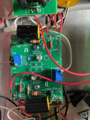

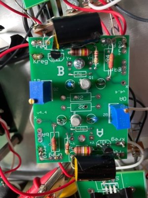

Hold on - it looks like I miss the connections at D2.
Offline hpleung
    • Posts: 137
Reply #10 on: January 03, 2022, 09:18:04 AM
So fixing D2, resolve the original issue:
"Kreg Regulator Board (both sides) 8-12V" ==> I now get about 9volts instead of the 3.34 volts I got earlier.
However, I am still unable to change the Bias. The voltage measurement at terminal 20 is still 215 volts.
Attached picture of my board.
