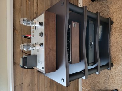

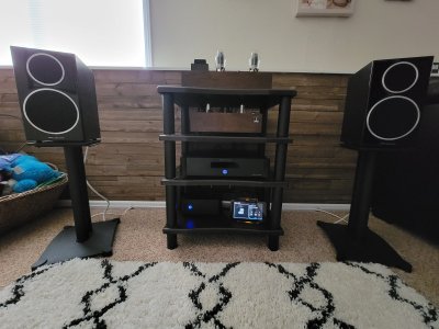

Reply #3 on: February 11, 2022, 10:45:15 AM
Finished her up and slapped on some stain.
After some rearranging I am really enjoying this pre. It's a bit overkill for my current setup, but I've never heard my wharfendales sing like this before. Vocals are Unreal.

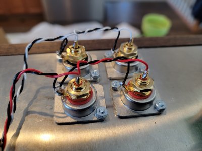

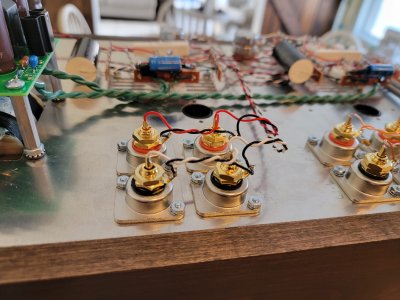

Reply #6 on: February 16, 2022, 10:30:10 AM
Hey Paul!
I went ahead and installed the new jacks. Before I fire her up, does this look correct to you?
    • Posts: 20206
Reply #7 on: February 16, 2022, 10:31:48 AM
Looks good!
