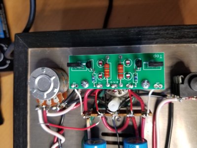

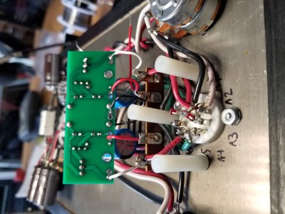

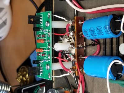

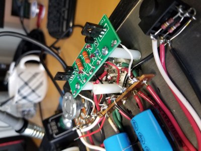

Here are some pics of the small board and U1-5 terminal connections. I have soldered the bigger board but have not added it to the build yet.
Edit: Hmm, pictures are best viewed in photo viewer.
« Last Edit: February 14, 2022, 09:07:28 AM by Baskevyl »
Mikhail Kostiouk
Reply #3 on: February 14, 2022, 11:36:03 AM
The only thing I see is that the wire going into A7 has way, way, way too much insulation stripped off and that could touch other terminals and cause problems.
Other than that, what I'm seeing would have me questioning the original voltage readings, can you double check?
