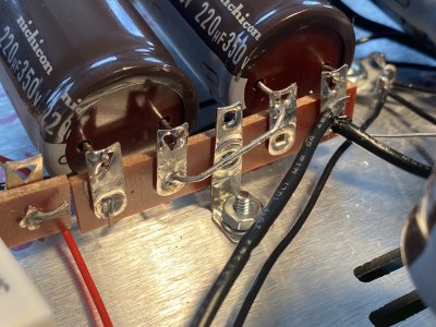

Can you post some photos of the power supply you have wired up?

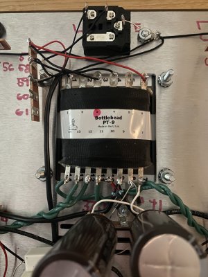

Hi Paul,
Here is my power supply.

Reply #3 on: February 19, 2022, 04:50:51 AM
You have not shown the terminals where you are getting the odd voltages.

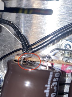

Reply #5 on: February 19, 2022, 05:03:18 AM
When you attach a capacitor to a terminal strip, you need to pass the leads through the terminal strip, then bend them up so they rest against the terminal strip, then trim them.  What I'm seeing there is that you have a lot of leads that have been cut super short and you are relying on just the solder joint to hold the capacitor in place.   For your build, I would push the caps in a bit more so the leads poke through the terminal strips a little more.
What DC voltages do you get at 14, 17, and 18?

Reply #7 on: February 19, 2022, 06:49:17 AM
Just resoldered and all of the voltages are in the correct range now! Thanks! Quick last question/concern I have - Is it problematic for little pokey wires from the L part of the strips to touch the underside of the caps that are mounted to the U parts of those same strips? Or are they insultated?

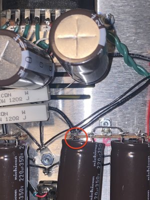

Terminal 14U should be reading 0VDC? In the manual for test voltages, it says it should be +-20% of 490, no? Terminal 14 is not wired to the star based on the manual, the closest is 18 on that tag strip.
Here is a pic of what I mean regarding the caps and touching stuff beneath them.

Sorry I mean to say 18 should be 0V.
The components touching the cap body are only a problem if they poke through the cap wrapper and the bottom plastic disc, which is unlikely.
