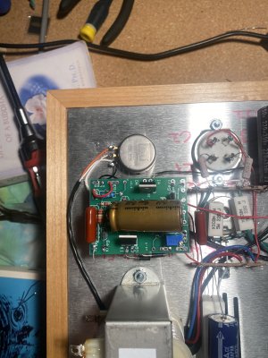

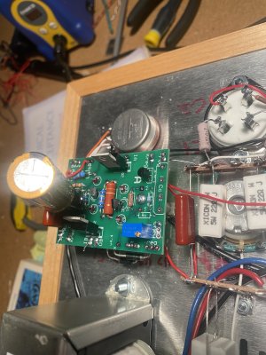

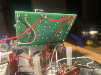

Can you post a photo of the top and bottom of the C4S driver board on that side of the amp? (0 isn't what I was expecting!)
ArtnShit
Full Member
115
Re: Driver Test Issue
Reply #8 on:
February 22, 2022, 05:41:56 PM
Here's the board!
a&s
Paul Birkeland
Global Moderator
20293
Reply #9 on:
February 22, 2022, 06:02:38 PM
You have both white wires from the 9 pin socket going to one of the Kreg set of pads and nothing connected to the other side?
ArtnShit
Full Member
115
Reply #10 on:
February 22, 2022, 06:27:45 PM
There it is! Moved white-D8 to kreg B-side and all is working well now!! Thanks so much, you solved it.
