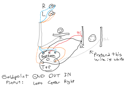

With the story out of the way, I'm confused on how this should be wired. From what I can tell the Goldpoint's pinout seems to be the same as the stock potentiometer. Looking over the manual to see where all the wires leading out of the stock potentiometer go, this is what I came up with:
R RCA pin -> GP Bottom row IN
R RCA tab -> GP Bottom row GND
L RCA pin -> GP Top row IN
L RCA tab -> GP Bottom row GND
Drain -> 8L
GP Bottom row OUT > 4L
GP Top row OUT -> 12L
GP Top + Bottom GND -> 1L
I've also attached an expertly drawn picture to better visualize what this looks like.
I'm not sure if L and R have to go to a specific row on the Goldpoint or not. I also did not put in any of the resistors that go between the stock potentiometer and the balance control. Does this setup work or will this explode now? Any advice would be greatly appreciated. All this over a knob, I know. :)

The drawing shows the L channel wires from the RCA to the GP reversed (the description is correct).

Hey thanks for the help. It works!
