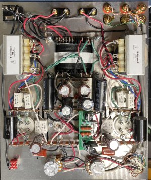

This may be fairly easy to debug with a couple of build photos.

Some build photos will probably help here.

Here's the photo Paul

Reply #7 on: March 10, 2022, 11:24:37 AM
This is very likely to be a solder joint issue on the C4S board.  I would reflow all of the joints other than the ones for the LEDs (they don't take much heat to solder properly).

 Paul, good call! All the voltage numbers check out. Thanks for your expertise.
