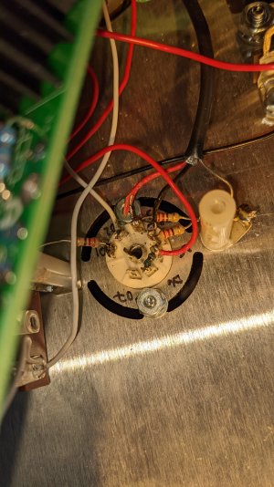

I've taken your suggestion and tried redoing all the connections on the D side of the 6aq5, but no luck so far. You mentioned the possibility of a bad tube, so I threw in yet another set, this time a 6005 instead of a 6aq5. When I did this, none of the LEDs on that side lit up, and the voltages that were already high went a bit higher still. With the stock tubes back in, behaviour returned to what was noted above. Does this point to anything, or is it just because of the different properties of the 2 tube types?
I've attached a picture - maybe someone with better and smarter eyes can see something I can't.
    • Posts: 20305
Reply #5 on: March 12, 2022, 01:28:39 PM
If you want to mail it back to me, I can look at it again.  It would be my preference that you'd go easy on the tube rolling once it comes back.
The 17V at the offending Kreg terminal means the 6AQ5 on that side doesn't have adequate operating current.  This could come from a shorted 6080 or possibly damage to one of the active loads from an unknown source.

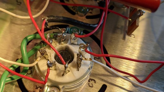

Thanks for the tips. I thought the green wires going to the 6080 might be a little too close, so I resoldered those to give a bit more space between the insulation and the joint. But that wasn't it. I then redid every connection on the 6080, but still no luck. I've attached a picture - does anything look wonky?
Shipping damage is not out of the question - a lot of screws had rattled loose, but nothing appeared to have moved too much. How would I go about checking to see if a part has died?
I'm trying not to send the amp back again, so any tips are appreciated. I'm still at the determined to fix it myself stage, but Mr. Birkeland, I guess you know how that turned out the last time.
    • Posts: 20305
Reply #7 on: March 13, 2022, 07:19:02 AM
You would swap the large high current C4S boards between channels.
