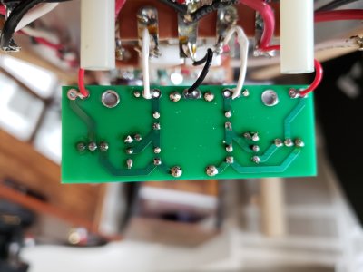

Can you unscrew the screws holding the board down, tilt it up, then post a photo of the bottom?

The led at A3 looks like it's not soldered Cant help with Ob.

A3 is soldered properly it seems, no pins touching in A or B. The amp passed all tests as a base crack and worked flawlessly for 2 weeks before I started this process, but I'm thinking I may want to do a full voltage test again? This one is stumping me.
