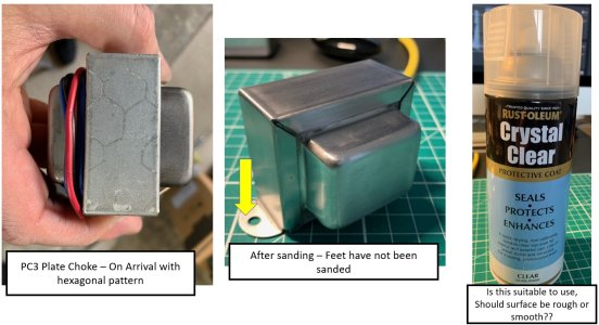

 When my S.E.X. kit arrived the Power transformer and the two Plate Chokes had hexagon patterns on the surface, probably due to being placed on something whilst drying?.
 Not a problem at all except the Plate chokes will be seen as they are on top.
 I have rubbed down and used Isopropanol to De grease them ( did not sand the feet ).
 The next thing i am planning on doing is Clear Coating just to offer some protection.
Will clear coating be ok or would thermal cycling be a problem?
I have supplied some pictures of what i have done and what spray i am considering using.
Any advice would be very appreciated, Thanks.

You can sand all the visible surfaces of those plate chokes since they have steel covers.  I have not used that particular Rustoleum product, so I have no idea what the outcome might be ;)

I've used this lacquer and it works well. For the PC I just cleaned with acetone. Mine didn't need sanding.

Thankyou for your replies,  I shall give this clear coat a go and see how it turns out.
Would you recommend roughing up the surface before spraying so it can key better or get away with leaving it smooth?

I think sanding in one direction will give you a nice appearance under the clear.

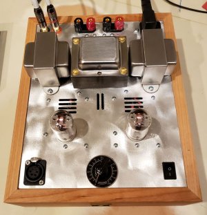

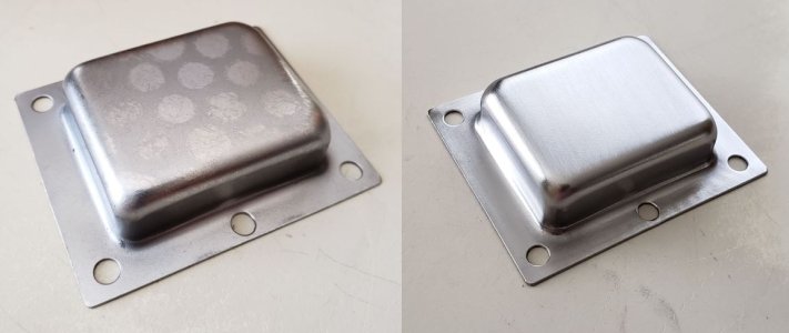

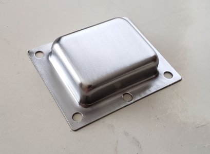

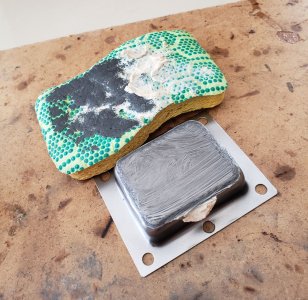

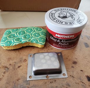

I did a coarse sanding on my S3X bell and chokes and the polished all with Mothers Mag aluminum polish only because I kept the top plate original and didn't want too much of a contrasting look.
On my new Crack, I did about 15 minutes of polishing on the bell. Depending on the time spent, it is possible to get a very nice finish with Mothers Mag.
Mine was all hand done. Using fine grit sandpaper and a buffing machine could probably turn out an amazing piece.

Thanks Mucker, Looks really nice. Are you going to spray them or leave them uncoated? I was originally thinking of leaving mine bare but wondered if they would tarnish over time.

For what it's worth, Mothers mag polish is for aluminum and that end bell is steel. Basically that means way more work than necessary to get a finish. An easier way to get there is with compounds designed to polish steel. Black emery with a sisal wheel works very fast on carbon steel.

Good info Doc! I just used the MM because that is what I had on hand and didn't want a mirror finish, just a near match of the plate. I bought it to restore the grungy disco dots on my SL-1200 turntable platters It works great for that.
