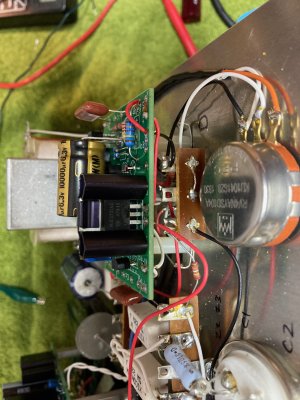

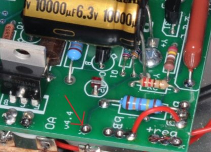

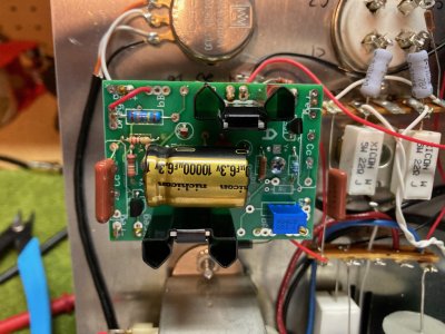

Can you post some photos of the 9 pin socket on the side giving you problems?
Offline Bobinsms112
    • Posts: 18
Reply #13 on: June 15, 2022, 11:56:15 AM
Hi Paul, see attached.
Thank you,
Matt
    • Posts: 20292
Reply #14 on: June 15, 2022, 12:44:22 PM
What's the voltage at the X pad on the B side?
From what I can tell, the B C4S that loads the 5670 works, the 431 bias circuit where the blue trim pot is works as well, you have a new 431 regulator on the other side of the C4S board (the B side, hopefully you didn't put the replacement in the A side), and with no 5670 the OA/IB voltage pops up to 360 which is what we would want.
The kinds of problems that this would leave would be solder joint and/or resistor problems in the regulator portion of the B side of the board, some kind of issue with the wiring on the 9 pin socket (if the grid stopper that goes from the 9 pin socket to the middle lug of the 5 lug strip behind the socket with all the zener diodes breaks off, you'd get some wonky annoyances like this), or possibly a broken wire going to Kreg on that B side of the board, or even a broken wire jumper on the PC board.
