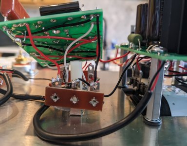

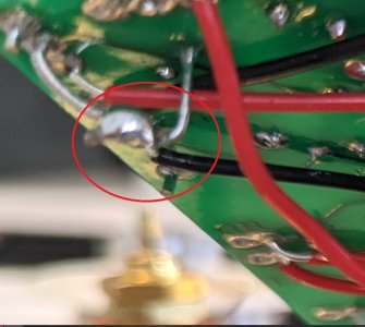

In the photos, you'll see a weird looking connection made on R4. This is one of my errors, which I believe I fixed. I put the 1W 220k resistor in the wrong 220k resistor place. Since the leads were already trimmed, I made a crude shunt to connect the breg point and +reg solder pads. It's pretty ugly, but I'm reasonably sure that the path is in the right order.

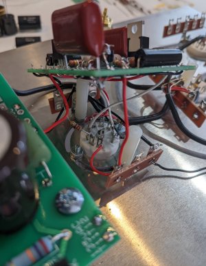

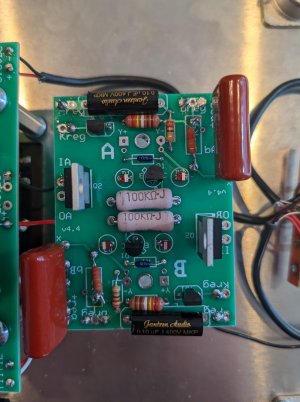

Attached are photos of my build. I hope they are clear enough for what you are looking for. If you need different angles, please say so.

Offline [email protected]
    • Posts: 9
photo 1
    • Posts: 9
photo 2
    • Posts: 9
photo 3
    • Posts: 9
photo 4
    • Posts: 20299
What happened here?
    • Posts: 9
From my original post:
I said it was weird looking. That is my ugly shunt.
