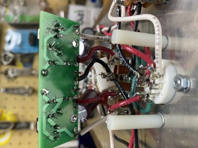

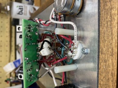

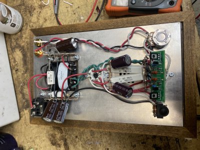

hope the pics help

try these photos

Re: Speedball Problems
Reply #8 on:
June 14, 2022, 04:55:40 AM
You have some substantial soldering issues that are going to cause some problems. I would review this soldering video:
Be sure you're not using lead free solder and also be sure your iron is turned up as hot as possible.
Your joints specifically haven't been heated anywhere near long enough for the solder to flow out and work properly, and this is also true for the solder joints in the underlying build. The exceptions to this (in other words joints to leave alone) would be the power switch and the solder joints for the LEDs, as they take substantially less heat to be properly soldered.
