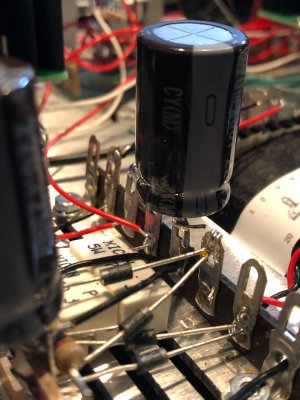

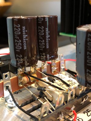

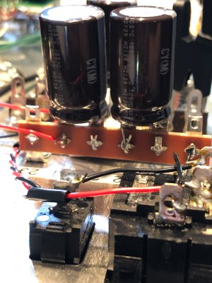

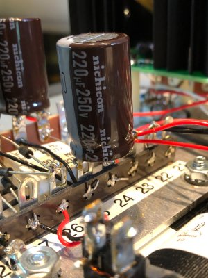

I decided that while I had it upside down I would trim some of the leads on the 220uF, 250V capacitors that I had left a little too long. That went smoothly and I didn't identify any other potential problems.

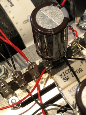

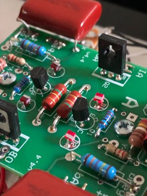

I reconnected the amp for a test run and there was no sound from the left channel. I determined that it wasn't the headphone cable or the tubes, and switching to different inputs had no effect. I put it back on the workbench and discovered that none of the LEDs were lit on one of the High Current C4S boards and only two were lit on the low current board. Additionally, only one of the LEDs was lit on the input tube. Thinking it was an issue with the capacitors I had worked on, I began checking voltages around them to see what was going on. Unfortunately, I shorted the lead of the 270Ω resistor that attaches to terminal 24L. I checked the resistance and it measures 264Ω but the capacitor that attaches to that terminal could have been damaged. Downstream, I noticed that one of the LEDs on the C4S board is no longer lit.

High current board with no LEDs lit
IA  211
OA  209
bA  0
IB  0.1
OB  1.385
bB  209
I suspect the problem is the 220uF capacitors but don't know how to check them. Any help diagnosing the problems would be greatly appreciated!

High current with one LED out
IA  191.7
OA  118.1
bA  0.4
IB  0.4
OB  76.8
bB  118.1

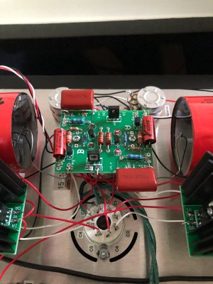

It's possible to remove the connections to the center board and rotate it 180 degrees.  If bRegA remains the same, that would be one direction to go in, and if the bad voltage moves to bRegB, that would be a different set of recommendations.
Offline Skipperrik
    • Posts: 75
Reply #6 on: June 15, 2022, 03:20:02 PM
Okay, the board has been turned 180 degrees and everything has been reconnected. The same LED on the high current board is not burning.

Low current (center board
IA  177.3
OA  72.5
KregA  6.44
bRegA  177.3
IB  149.7
OB  72.7
KregB  8.66
bRegB  149.7
    • Posts: 20302
Reply #7 on: June 15, 2022, 04:02:52 PM
Low current (center board)
IA  177.3
IB  149.7
Going from 117 to 177 wasn't expected.
I would be looking for loose connections on the 7 pin socket and the wiring to the board and on the board itself on the high current C4S board with the LED that's not glowing.  You've verified that the center board is working properly and the 12A7 socket is wired properly, so you're left with the 6080 socket wiring and the 6AQ5 regulator tube and high current C4S wiring.  If you pull the 6AQ5 on the offending side, what OA and OB voltages do you get on the high current C4S board on that side?

What I would be looking at next really carefully would be the resistor attached to pin 1 on the 7 pin socket under that board, as well as the resistor between pins 5 and 6 on that same socket.  One of those that's loose or broken will make some issues like this.
Offline Skipperrik
    • Posts: 75
Reply #10 on: June 16, 2022, 05:25:20 AM
Pin 1  214
Pins 5 & 6  236
The problem is on the board above the B socket. I got the same resistance readings on the D socket.
I re-flowed the connections at the resistors as well as all of the pin connections at the B socket and the C socket. There was no change in the resistance values and the LED is still out.
