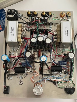

Previously I had posted about having no sound in my right headphone driver while using the S.E.X. 3.0 Kit and I got a recommendation to just touch up joints T6 and T7 of the right channel output transformer. This seems to have given me sound in right driver but upon further listening it's significantly quieter than the left.
Things I've tried:
Swapping the tubes again yet the channel imbalance doesn't follow the tubes.
Hooked up the S.E.X. 3.0 amp to a digital source and played a test tone, it made it very clear that the right driver had quite a bit more volume.
Using different RCA cables.
Different pairs of headphones.
Everything has passed resistance and voltage checks.
Thank you for the help on my previous post yet I still need some assistance.
Attached is a current picture of the wiring in my kit.

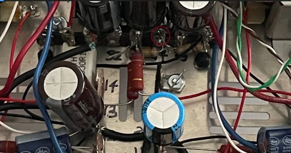

Jet Spear
    • Posts: 20302
Here's a joint that doesn't look soldered.
I see lots and lots of untrimmed leads.  I would get a set of side cutters (something like the CHP-170) and trim all those random leads back.

I've cleaned up those untrimmed leads and took a look at that joint, it feels solid but I'll be sure to touch it up. While checking it out I discovered the terminal next to it (36U) looks really off up close and actually feels quite loose! I'm gonna redo everything on that terminal tomorrow.

You might go back and redo your voltage measurements. Note any differences between channels now that you have the circuit working.
    • Posts: 20302
You appear to be missing the resistor at A10.
Offline Jet
    • Posts: 27
The resistor is at A10, it's just that you can't see it in the angle of the picture.
I did voltage checks again, everything is within the recommended values.
