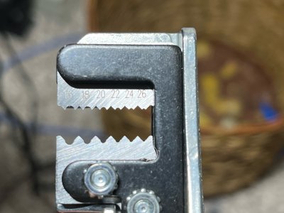

I contacted the Ideal Customer service. According to them, my stripper should have two labels of holes, one on the top cutter blade, the other on the bottom blade. One is for stranded and the other for solid. Mine only has labels on the top blade. I have sent a picture to them, which they will bring to the attention of production. They promised to get back to me.
When looking at my old manual stripper, the holes are labeled differently for solid and stranded. The hole for 22 solid is the same hole used for 24 stranded.
I naturally assumed with my ideal stripper that one used the same hole as the wire gauge. If Paul says it's OK to use the 24 holes, then I will use it with confidence.

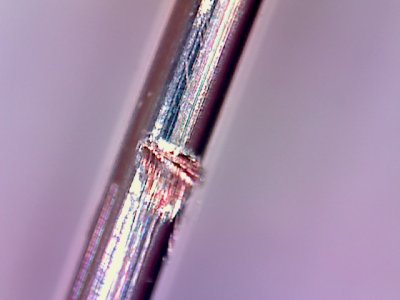

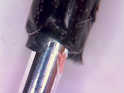

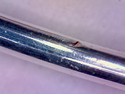

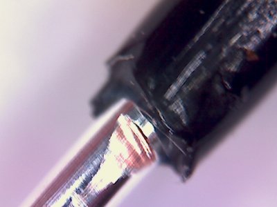

Reply #8 on: July 22, 2022, 10:42:53 AM
Doc,
 I did what you suggested and then took pictures with a usb microscope.
There is a nick seen where I did the first strip as well as a nick next to the insulation where I did the second strip.
The defects don't seem large, but I know from my schooling that even small defects in metal can produce a stress riser which can be a weak point.
I suspect these won't matter, but "Who Knows?"
I stripped the same wire with my old stripper. It left a small mark, seemingly less prominent than with the stripmaster.

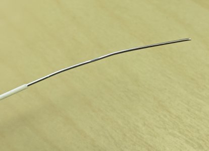

Reply #9 on: July 22, 2022, 12:41:20 PM
So now you have hands on info to make your own judgment. Well done.
Here's a pic of a white Teflon wire I just stripped with my old Stripmaster on the 24ga. slot. The jaws hit just about in the center of that bare length and I pulled the insulation back after stripping to expose the area. A nice clean strip, I see no nick, nor do I feel anything with my thumbnail.
I would guess that this indicates either a tolerance issue with yours or that my old stripper has somehow worn to the proper size. It does leave some insulation when used on the 22ga. setting as noted above. I have had this stripper since Ed Fallon gave it to me in the early oughts. I believe at the time it may have been surplus from Medtronics so it's pretty old.
