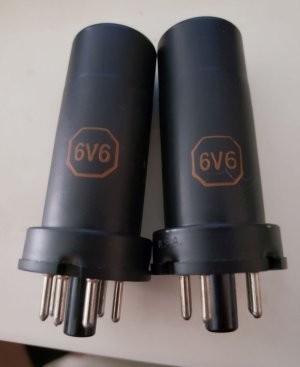

I posted some relevant information I am sure you will read in another thread. A question for Paul. It seems a metal tube would offer better immunity from outside interference than a glass tube. Is this plausible?

The metal envelope may indeed do just that.

Reply #6 on: July 31, 2022, 05:14:28 PM

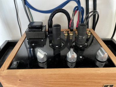

Fascinated by the threads on Black metal 6V6s. Got a pair of NOS RCA's on eBay. They've been running for several days. I'm quite pleased. The sound is very smooth and lush.

Looks great! They are fine tubes IMO.

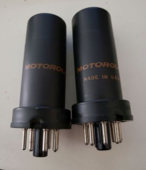

Found a pair of NOS Motorola tubes for cheap on eBay. They sound great, as good as any of the glass I have. I don't find them to sound solid state at all.
