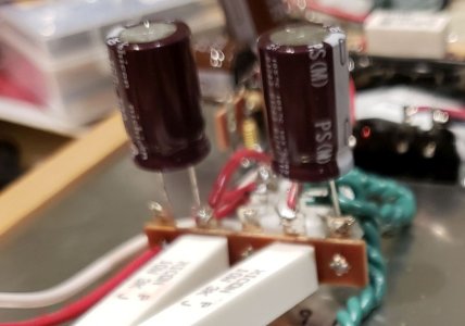

Here is a picture of my build:

Also, I noticed that a 270 Ohm resistor is getting so hot that it's melting the solder on T14 and T15, such as that the standing cap can be moved with no effort.

It looks like your output caps (both) are installed backwards. Take a look at your manual, the white bands on the caps should be facing outwards.
You're absolutely right! I'll go ahead and reinstall them. Thank you!!!

Switched the output caps orientation and problem solved!!! Voltages are now just right.
