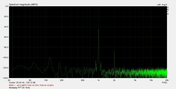

I didn't have anything quite like this ready, so I had to spend some time putting something together and thinking about what made sense for testing.  Ultimately I figured that grabbing an FFT shot at about 2V of output made sense, but bear in mind that I didn't make any effort for noise reduction as this is only really about THD.
Anyway here's what the THD looks like in the Moreplay at 1kHz and 2V.  There just isn't much beyond that 2nd harmonic and I don't even really see the 3rd pop up above the noise floor until over 2.5V of output from the preamp.  The 60Hz/120Hz noise that is seen is stuff that we generally deal with in planned future upgrades, and we are in board design right now for one of those.

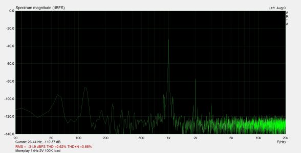

I also increased the loading on the Moreplay from 10K up to 100K, and there is a commensurate reduction in THD accordingly.  C4S loads will also bump this down in the future.

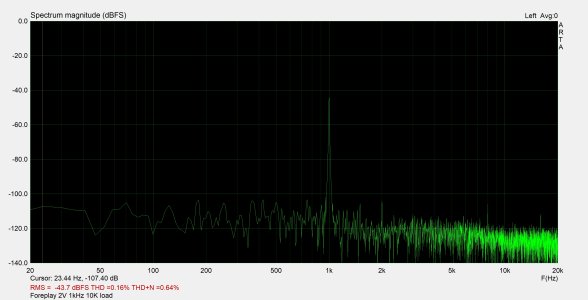

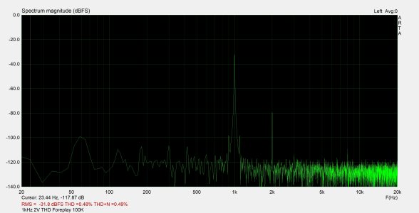

Here are some measurements from a non-C4S Foreplay II that has LED biasing but is otherwise relatively stock.  What I found rather odd is that the THD performance is a bit better into 10K rather than 100K, which is exactly the opposite of what I would have predicted!

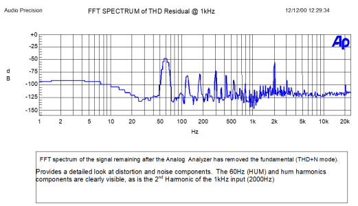

I have these measurements from a Foreplay I. Amazing I still have these.
December 12, 2000 - Foreplay Measurements by Craig Lewis (elcraigo)
All measurements are unweighted into 100K ohm load.
tubes: GE 5963 (came with kit), Kit stock except magnet wire.
Equipment used:  "Audio Precision System I"  with DSP (digital signal processing) option installed.
Input      Output      Gain   THD+N% @1000Hz
1Vrms      1V           0dB    0.2%
1Vrms      10V (max volume)    20dB    0.9%
2.25Vrms   22.6V (max volume)     20dB    5.1%
Signal to Noise (s/n) @ 1kHz = -79dBr (preamp gain = 0dB, 1Vrms input)
Frequency Response (-0.2dB, +0.07dB, 10 Hz to 50 kHz; -0.05dB @10Hz,  -0.16@50kHz)
   Input: 1Vrms
Output: 1Vrms
Reference: 0dBr @1kHz
Phase Input to Output (0Hz to 50kHz)  -196deg to -177deg (yea it inverts or -180 deg)
Craig Lewis (elcraigo is a nickname a good friend who grew up in Mexico gave me)
