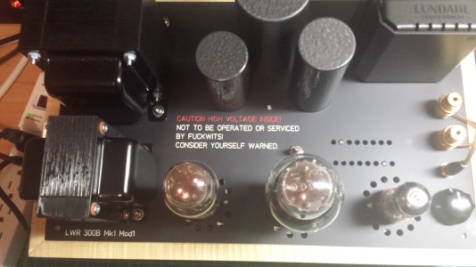

Hi:
One of my Paramount V1.1  300B amps may have the beginning of a problem.  Approx. 10 - 15 seconds after turn-on, there is a relatively low level audible pop.  I have tried 3 different 300Bs and it happened with all of them.  It does not happen with the other amp.
Even though it's supposed to be closer to 30 seconds, I'm wondering if this could be when the B+ is applied?  In any case, is this an indication that a part may be starting to fail?  I wouldn't swear to it but over the course of the last week or so the pop maybe getting louder.  Thanks!
Gerry

Offline Gerry E.
    • Posts: 192
Reply #9 on: September 25, 2022, 05:16:11 AM
Guys - Thanks for all the replies!  The first thing I did after PB's initial reply was to swap the 6SN7 for a WE 396A.  The problem remained, so that's how I knew it wasn't the TS RP 6SN7 nor the adapter (Garage1217).
Here's a bit more information about the symptoms.  Upon turn of the amp in question, there's hiss that slowly dissipates into a POP and then dead silence.  Of course once I hit play, the amp plays fine and sound great.
Gerry
