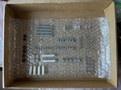

I’m sure others have thought of this, but the one-sided sticky bubble wrap that the kit came with is perfect to hold and keep track of all the screws and other small bits.

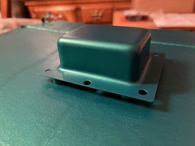

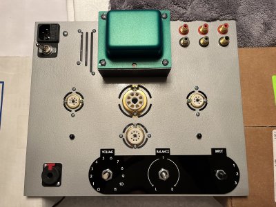

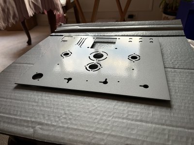

Finished going through the inventory checklist, and then painted the chassis plate (Rust-Oleum Universal hammered silver) and power transformer bell cap (Rust-Oleum Custom matte emerald green). Two light coats, a medium coat, then a heavy coat. It’s been drying for four days now. My emerald green spray paint was spitting the last time I used it, and Doc’s tip in the Bottlehead YouTube tutorial about letting it sit in warm water for a while solved the problem for me. Thanks, Doc!

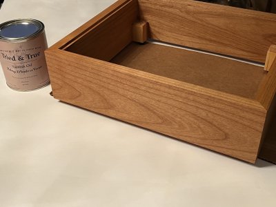

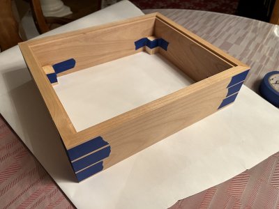

Glued the wood base yesterday and am about to apply the first coat of Tried & True Varnish Oil today—I really like its formula of just linseed oil and pine resin. In the YouTube tutorial, Doc said, “If you have a desire to finish the whole inside, knock yourself out!” I then thought to myself, “Alright, I will!” Haha, this is a labor of love for me and an amp I’ve wanted for a while now. So, I’m trying to—forgive the old phrase—leave no stone unturned, and make this as nice a finished product as I can.

Those colors should work really well together.

Thanks, Paul! Yeah, I was going to spray-paint the bell cap black, but then thought, "Eh, why not give it a little more pop?" I already had the green paint anyway.
Alright, just applied the first coat of the varnish oil. Will wait 1 hour, as the instructions indicate, then will wipe/buff dry. Then after 24 hours, I'll lightly burnish with 0000 steel wool before the next coat. I plan on doing four coats, so not rushing the build process at all.

Very nice job on the finishes.

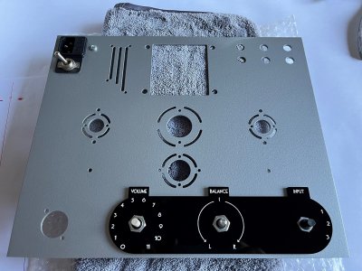

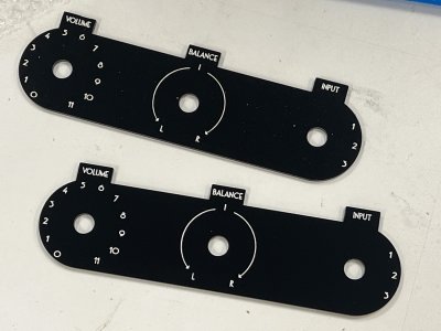

Just got a message that my custom control overlay is finished! A photo was sent too. Should arrive by the time I'm done with the wood base.

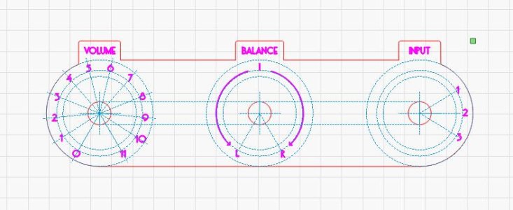

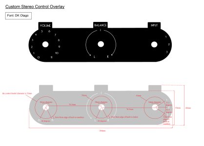

I measured the C2a chassis plate and designed a simple overlay in MS Paint, then found someone on Etsy to laser-cut it out of acrylic. The seller/craftsperson first had to make a computer model/proof with all the correct measurements. This was good as my Paint version was done by eye so is imperfect with regard to proportion and centering. I was thrilled to hear that the text would be done by engraving and then filled with a powder coat, so I shouldn't have to worry about it fading. And the price was $25 for everything, which was definitely less than I was expecting. The first overlay made had an imperfection on the top of the "volume" tab, so the seller made another and is giving me both. I can easily sand that imperfection and the rest of the tabs to make them uniform, and it'll be nice to have a backup.
But yeah, it's really cool to see the idea I had in my head realized. I wanted it to look a little 1930s, so the Art Deco font called "DK Otago" helped a lot with that.

A nice surprise, the custom control overlay came in today! Was expecting Monday.
I'm very happy with how it turned out. The glossy acrylic gives off some dreamy reflections! It is 1/8" thick, so the stock volume pots would've been too short. I did measure the Audio Note pots and stock selector switch, they're all just long enough. Whew! If they weren't, it'd be no problem sanding down the bottom of the control overlay.

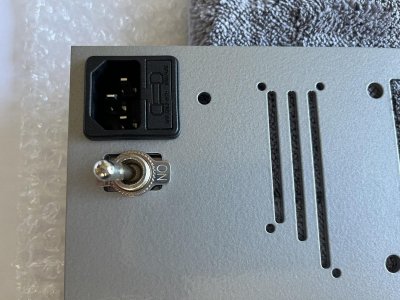

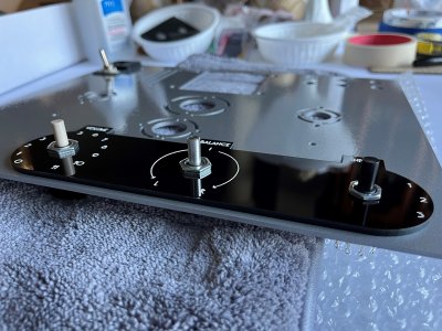

Also, I really like using heavy-duty toggle switches, but needed to find a way to cleanly install it. The cutout for the stock rocker switch is wide enough for the toggle switch to mount securely, but the corners of the cutout are visible. I wanted to use some thick plastic as a rectangular washer to cover it up. So, I cut a piece from an old Blockbuster DVD case that wasn't being used. The case is still usable, just a small amount was cut off it. Then drilled it and cut it to size with some heavy-duty scissors. Things are coming along nicely. :)

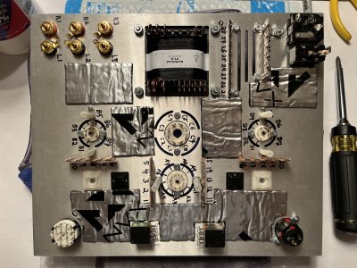

Finished installing the components last night and am ready to solder! Just waiting on the wood base's last coat of varnish to cure. Will work on the soldering little by little each evening.

Always nice to see someone going the extra mile on the finish and some customization. Your solution for the power switch works well with the control overlay. Keep the pics coming as you bring it to life.

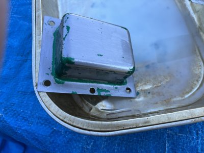

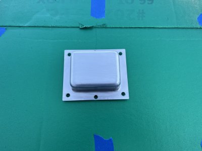

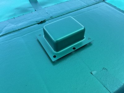

So, I had a bit of a blunder.... just noticed it this morning. When I tightened the screws of the transformer bell cap last night, the paint tore away a bit. Maybe I tightened too much?
I could spot/dab some paint, but I want to do this right. I'll take out the power supply, strip the paint, and re-do it. Then when I screw on the bell cap again, instead of holding each nut and turning the corresponding screw....I'll hold each screw, and turn the corresponding nuts. Hope it'll go well. If any tearing occurs again, it should be more minimal and I could then do the spot/dab painting with a toothpick.

I've been in the same boat before. Some of these paints take a week or two to fully harden. It's something you cant rush.
    • Posts: 20299
Reply #14 on: October 03, 2022, 10:47:07 AM
Take each screw out carefully one at a time, then put a copper washer under each one and put it back.
