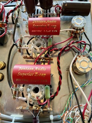

Well, I bit the bullet and did my first ever cap upgrade. Wound up with Jantzen caps. I'm really happy so far. They've only been in for about 10 hours of playing time so I don't think they're fully broken in. Immediate difference is more detail, but not clinical. The Moreplay has made a huge difference in my second system. It definitely punches way above it's weight class.
