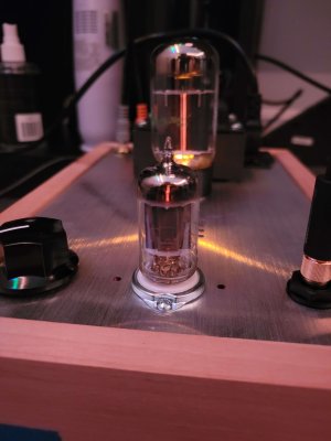

As the title states, anytime i bump the desk, type or touch the headphone jack/tube it sounds like i can hear the metal from the plate amplified (go figure) through my headphones. It is a fresh build and passed all tests with no issues and actually sounds amazing aside from this hiccup. Using DT1990s and have tested 3 different cables all do the same thing. Fiddling with the jack on the cans themselves does not reproduce the sound. Less of an issue but ive also noticed a very minor oscillating hiss or quiet static when there is no audio being played. It seems to happen in roughly 5 second intervals. Im open to any and all advice! If you need anymore info just let me know and ill do my best to answer in a less than ignorant way hah. Thanks in advance

The noise you're hearing at 5 second intervals would most likely be interference from a wireless device that's close by (your phone can even do this).
What you're describing is a microphonic tube, and there's no harm in continuing to use that tube.

so the interference was fixed when i moved the amp (good call you are right). i realized it was on the same level as my router just on the other side of the wall so that has been fixed. however the ringing is a bit annoying as i move my head while im working and typing is audible through vibrations basically. this is my first tube amp so i dont really know whats normal and what isnt. I wouldnt think movements and MINOR vibrations would affect it much

You can also try placing a silicone ring or two around a microphonic tube to dampen vibrations.  They don't always work, but they're cheap to try:
https://www.tubesandmore.com/products/damper-rings-high-temperature-silicone-red

A little bit of microphonics isn't abnormal, but if it's annoying you could just buy an inexpensive replacement tube.

ah that would be a cheap fix. i had actually thought about putting a rubber grommet of sorts around the base of the socket where it attaches to the metal plate but its nice to see this isnt just a ME problem hah

gotcha, so the idea here is to just tube roll and maybe find a tube that doesnt have as bad of microphonics? im not apposed to this idea as i wanted to tube roll eventually anyway just want to make sure i understand correct. microphonics is a natural thing and i did not goof on my build somewhere, and can be combated through dampeners and tube rolling.

That's an inexpensive way to get into tube rolling.
