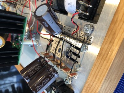

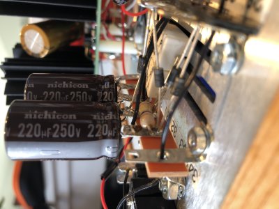

The fuses arrived so I took the amp back to the workbench. I looked carefully at all of the connections at the terminal strips like you suggested and couldn't find anything that would cause a short. I replaced the blown fuse, plugged it in and it immediately blew the fuse. It was really puzzling me until I noticed that the base of the capacitors were actually touching the terminal strips. I had cut the leads a little short and they weren't standing clear of the strips. I bent them at an angle to the strips, replaced the fuse and powered on the amp again. That was apparently the problem. No blown fuse this time. See the before and after photos.
