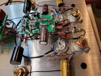

I have a major hum coming from both channels on new build.
Also, there is no separation between channels. Source connected to one channel comes out on both sides.
Offline olegreg
    • Posts: 26
Reply #1 on: November 28, 2022, 09:08:35 AM
I wanted to add that the input is shorted to rule out outside sources.

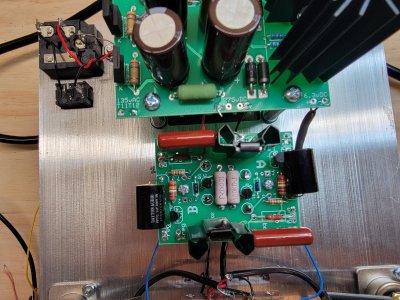

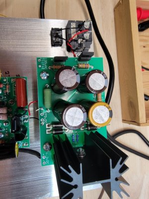

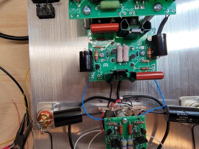

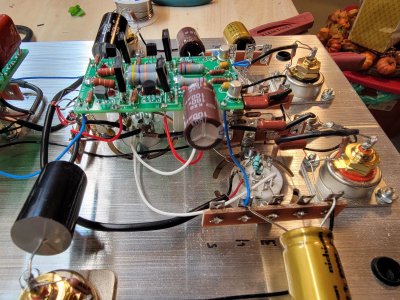

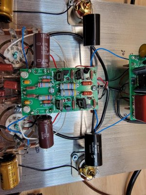

Reply #5 on: November 28, 2022, 11:42:32 AM
Here you go

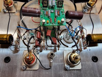

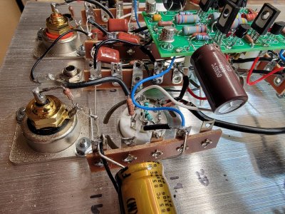

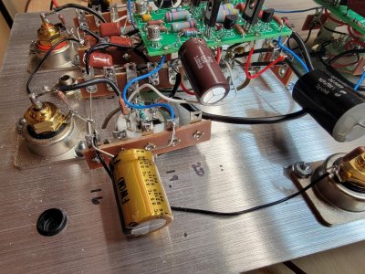

Offline olegreg
    • Posts: 26
Reply #6 on: November 28, 2022, 11:57:15 AM
Hum was with SUT wired in per instructions. Rewired without SUTs (pictured) and no hum through headphone.
I must have done something wrong with the SUT wiring.
It was not clear on where to land A1 and B1. I landed on 2 and 15 putting the loading resistor on the secondary of SUT.

Offline debk
    • Posts: 658
Reply #8 on: November 28, 2022, 01:50:27 PM
From the pictures it looks like D2 on the B side of the shunt regulator board is in backwards

Offline olegreg
    • Posts: 26
Reply #10 on: November 29, 2022, 08:34:40 AM
First: Debra K, Good eye!  Those LED Diodes where probably the hardest component to install on a board. I'm surprised the VDC all checked out, but on close inspection in a darkened room, it was not glowing.  Thank you, Debra
Second: On the sewing machine hum. Paul nailed it... My Sonos sound bar is causing the hum. I will just have to turn it off when I want to listen to music. Thank you, Paul.
