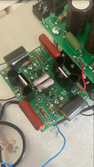

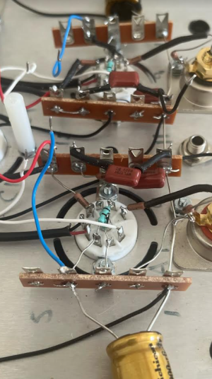

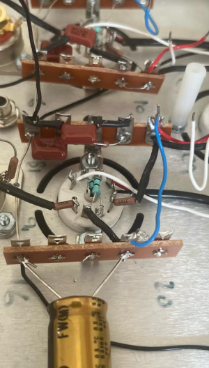

Images of the board and affected EF86 side

The solder joints on the board generally look good, but in a few spots I see a joint that has either a small gap between the lead and the pad or a solder fillet that doesn't completely surround the lead and cover the pad evenly. Those could be cold joints so it might be worth reflowing them one more time.

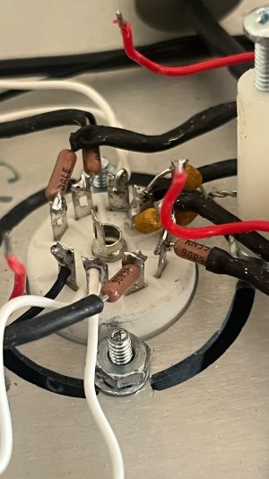

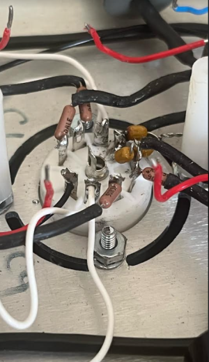

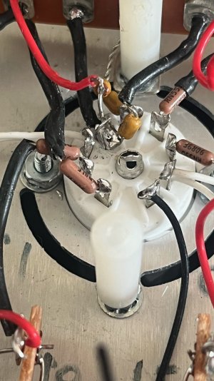

Could you post some photos of the C socket?

Apologies forgot to post these before- I have since fixed up the excess solder on pin 4 and there is no contact with the adjacent pins, but the problem remains the same. I used a multimeter and checked connections from pins to their attachment points and they are also well connected.
    • Posts: 20343
Reply #11 on: January 04, 2023, 04:07:06 AM
If you have an adjustable temperature soldering iron, I would turn it all the way up.  A lot of those joints don't look like they have had the chance to flow out properly, which will happen with insufficient heating.

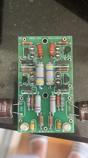

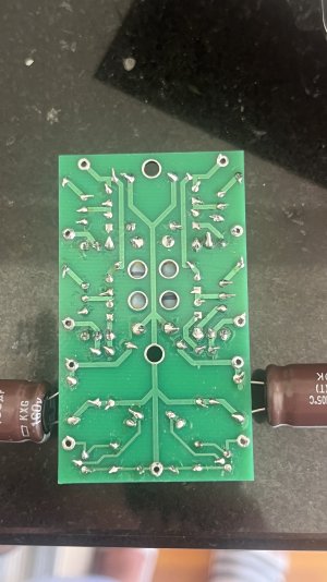

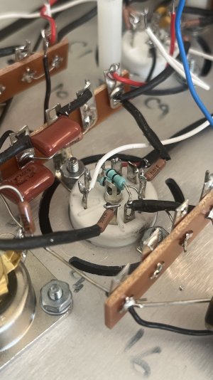

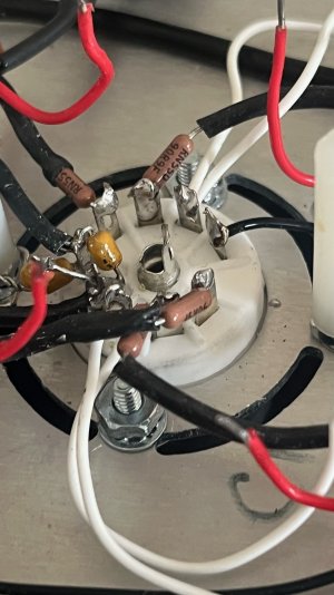

Can you post some fresh pics of your resoldered kit?
Offline tintin
    • Posts: 38

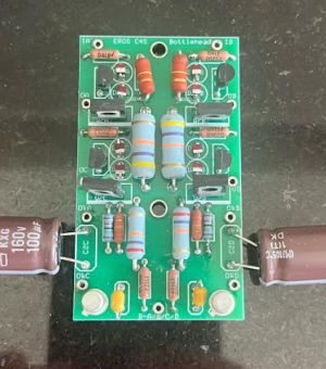

Reply #14 on: February 07, 2023, 07:28:45 PM
Here are photos of the EF86 and 6922 sockets, as well as the boards
