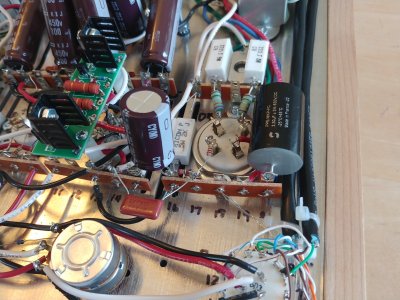

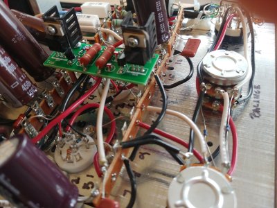

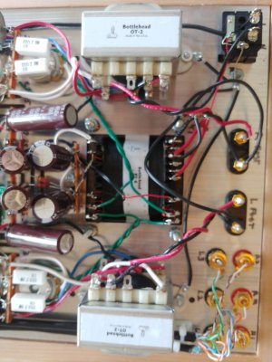

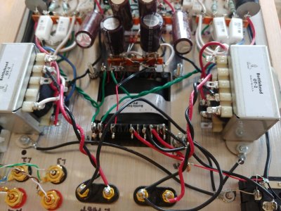

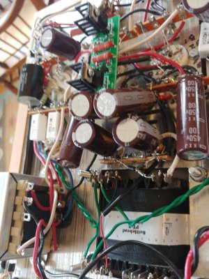

Can you post a photo of the build in that area?  0V at terminal 14 would make me suspicious that one wire isn't hooked up to the PC board.
Offline jmittan
    • Posts: 6

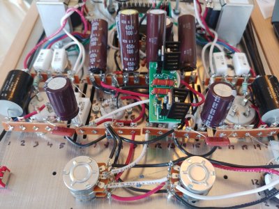

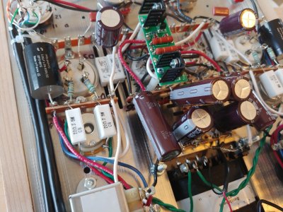

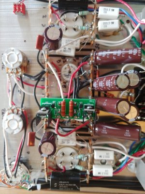

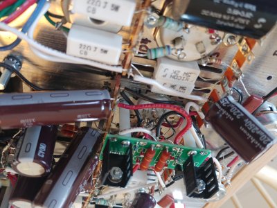

Thanks! Here are some photos.
    • Posts: 20302
You can pop the wires out of IA, IB, OA, and OB, then rotate the board 180 degrees and reinstall it to see if the voltage problem moves to terminal 7 (which would indicate an issue on the PC board) or stays put at terminal 14 (which would indicate an issue around the socket wiring or terminal strips).

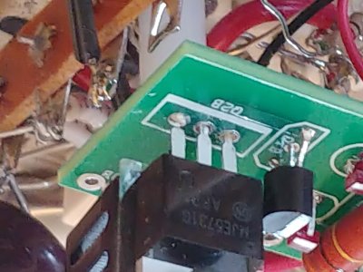

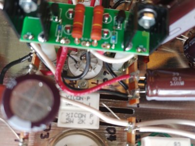

I think I found the problem. One of the leads (closest in the photo attached) appears to have broken. Not sure how to resolve this. Do I solder a blob from the top of the PCB to reconnect?
    • Posts: 20302
A solder blob could probably be used to fix that.
Offline jmittan
    • Posts: 6
Thank you! much appreciated. I was able to "graft" a cut lead through the through-hole onto the lead of the MJE5731A and solder all together. Terminal 7 reads 203 and terminal 14 reads 184. Though it is now +-15 VDC on the other side, at least it is in the recommended range of 170-230.
