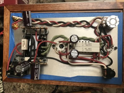

Hi guys,  having issues.  Something is definitely not right here
T01: -.9
T02: -.9
T03: 0
T04: -.9
T05: -.9
T06: 0
T07: 0
T08: 0
T09: 0
T10: 0
T11: 0
T12: 0
T13: -.9
T14: 0
T15: -.9
T16: 0
T17: 0
T18: 98.4
T19: 98.4
T20: 0
T21: 241
T22: 0

T15: -.9
T21: 241
Terminals 15 and 21 are connected with a 270 ohm resistor. One end of that resistor is loose or poorly soldered.
I thought there was something wrong with that resistor,  its dead.  solders are great on it,  it got super hot and i burnt my finger on it.

That resistor will only die if there's a catastrophic short, which should show up in your resistance checks.  Just buying another one and replacing it will lead to more dead resistors.  Is the other 270 ohm resistor in-tact?  Usually that is the one that fails first.
Is that black wire that's supposed to go to 14U going to 15U instead?  How were your resistance checks?

resistant checks were all spot on.  its the insulation pulled back off the wire there,  its going to 14u

looks like both resistors are dead.  getting  nothing from both when checking them

Are pins 1 and 2 touching on the 9 pin socket?
Having both resistors burnt means that your resistances at terminals 2, 4, B2, and B5 should not measure correctly.  Can you let me know what resistance values you get at those terminals?

it does nothing when i measure between 12u and 2,4,b2, b5.  man i hope im not reading my meter wrong.  does the * in the manual mean there should be no resistance?
a1,and a2 dont touch  pretty close but there is room for movement and still not connect

No resistance would be 0 Ohms, which would be a short.  If your meter says "OL", that would mean infinite resistance, which is desired.
For the resistors to go from 270 ohms to open without the cement housing cooking and falling off means they were shorted to ground, so this issue has to be found before replacing them. This doesn't happen on its own without a cause.

would the cap being reversed do that,  i had the wrong cap on 14u, 15u.  didnt realize it they were all different.  I then switched it with the right one and put it in backwards but I thought i caught it before powering up

Yes, a backwards electrolytic will create a dead short.

Just to clarify the electrolytic caps aren't all different. There are just two values supplied in the kit. The caps in the power supply around the power transformer are three 220uF 250V capacitors and the output coupling caps by the 6080 socket are two 100uF 160V capacitors.
Once power has been applied to a power supply filter cap that has been installed backwards it has been stressed to a point that it should probably be replaced even if it still seems functional.
