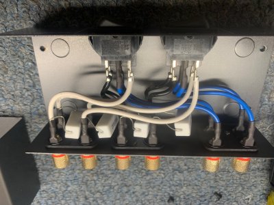

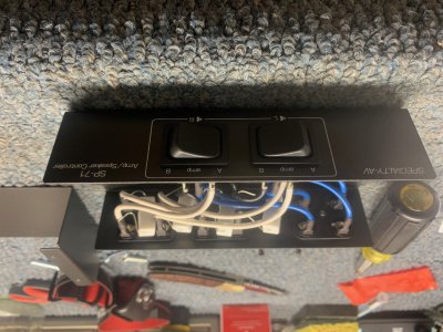

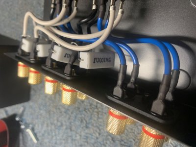

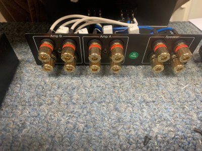

I built a Stereomour II amplifier and I am extremely fond of it. I thoroughly enjoyed the process and I enjoy the sounds that it provides to my ears. Recently, I have obtained another amplifier and I would like to be able to switch from one amp to the other for a variety of sonic sounds. The caveat, I only have one pair of speakers! I have found the SP-71 by Specialty AV that should solve my problem, I just wanted to get some technical advice to make sure that my Stereomour II will be safe using it with the SP-71 switch box. There is not a whole lot of information or reviews of people using this with tube amps. I have attached pictures of the inside wiring of the box with the resistors(5w100ΩJ) and switches. Anybody else run into this situation? or have a recommended trustworthy switch box that they would recommend? Will the Stereomour II be safe/protected to run with the SP-71? Thanks in advance for your thoughts, recommendations, and technical advice.

Reply #1 on: May 09, 2023, 05:36:12 PM
That looks like it should work, the resistors are probably there to provide a load to the unused amp. If the amp you are not listening to is switched off, you probably don't need them...John

Reply #2 on: May 09, 2023, 05:37:17 PM
Well, the SM2 can be run without a load on the outputs either 0 ohms 8 ohms or 100 ohms. Having no knowledge of your second amp it may have to have a load when it is turned on as in a tube amp with a feedback circuit or a transistor amp that requires a load while turned on. My opinion is to clip off the 100 ohm resistors on the SM2 input and inquire if your second amp requires a load to run safely. Do you intend to run both amps at the same time and switch back and forth? If no then I would lose all 4 of the 100 ohm resistors. ymmv. what s your second amp?
