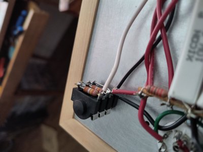

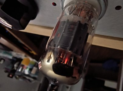

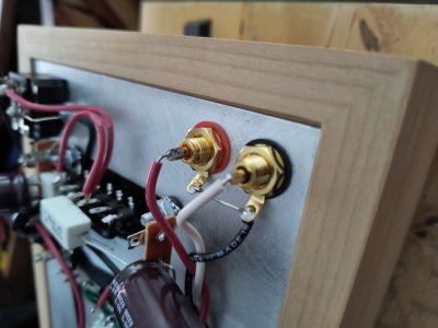

I just finish building my Crack and all the voltage test pass. Power it up and everything seem to works... untill i put my headphones on my head. No sound for my right ear.... I resolder the red RCA Jack made sure everything is welded and wired properly like 4 times. I did notice that the 12AU7 Tube did glow both half but one half was way dimmer thant the other side.

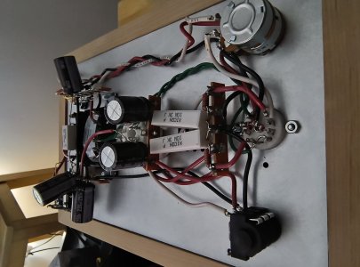

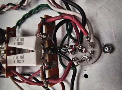

Here are some pictures of the build
    • Posts: 20299
Reply #2 on: May 11, 2023, 04:27:07 PM
The 12AU7 should be just fine since your DC voltages are correct.  Could you show the terminal side of the volume pot?
There are some 1/4 to 1/8" adapters that don't quite work properly in the Crack's headphone jack.  If you're using one, I'd try a different set of headphones to be sure it isn't something simple like that.
