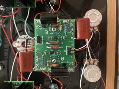

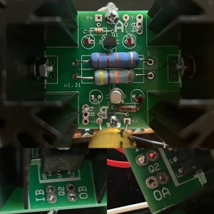

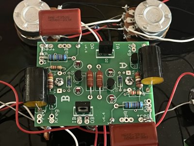

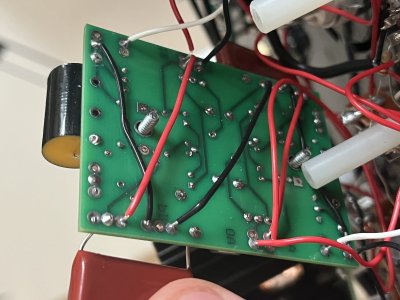

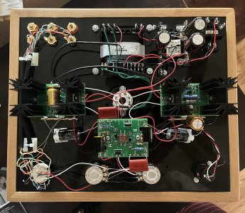

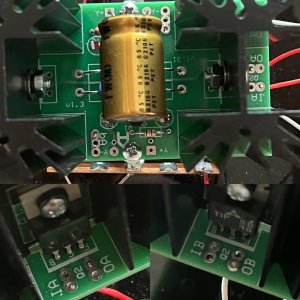

Doc, the meter auto ranges. Paul, I've attached a few pictures that will hopefully help.
I took these pictures AFTER the posted measurements. You can see I hammajammed the LEDs pretty good so that will be remedied when my new LEDs show up. Unfortunately my kit didn't come with any extras. And the powder coat is removed where the grounds need to make contact. That headache was solved with the forum luckily.

Looks like you should reflow all circuit boards usein more heat and solder to flow through the holes and onto the pads on the top side of the board.All the componants can take te heat except the led's and the small transistors.
    • Posts: 20286
Reply #6 on: May 17, 2023, 02:30:13 PM
Do this, but maybe don't do it for the LEDs on the PC boards, as they require very little heat to be soldered properly.
