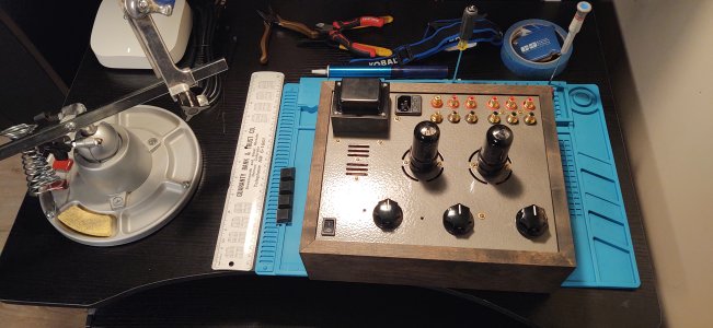

Moreplay finished. Now to listen.
    • Posts: 20297
Reply #1 on: May 21, 2023, 04:49:04 AM
The washers are a great idea with the hammerite paint.

Reply #3 on: May 25, 2023, 11:19:59 AM
Looks great. Did you add an extra output?

Reply #4 on: May 25, 2023, 11:37:02 AM
Yes, I needed an extra output for my sub

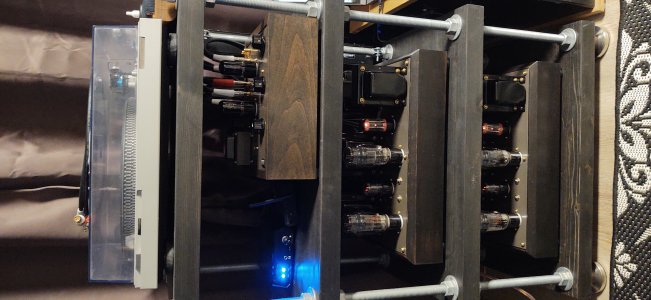

Just got it hooked into the system. Two JE Labs Simple 45 modified to run 2A3s, big Edcor iron. So far it sounds fantastic 😍.
