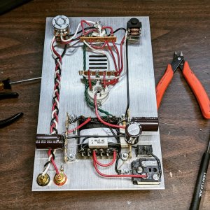

For starters you need to twist the green heater supply wires and braid the red, white and black signal wires from the RCA jacks to the volume pot. The instructions are detailed in the assembly manual. Either of those not being properly dressed could be a reason for excessive hum so they should be corrected first. Once that is done if the hum persists we can start to look at other possibilities.
I have attached a photo of a partially complete Crack amp I am currently assembling so that you can have an idea of what the wiring layout should look like.
