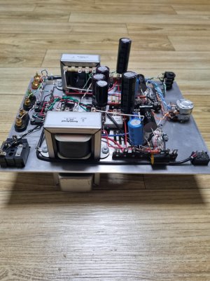

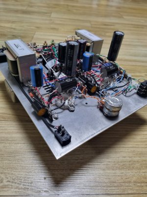

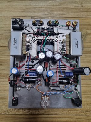

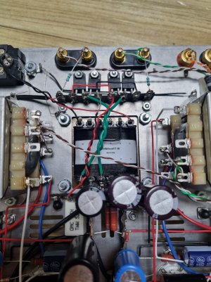

Hello everyone, I just completed my S.E.X 3.0 kit, and it sounds very good! But.. I am experiencing varying hum/ringing as I move the volume wheel (on hd600, and very present in lower impedance headphones). It is my first time doing any soldering and DIY electronics.. Could anyone help me out?
Symptoms:
AMP set at 4ohms, with hum that varies with the potentiometer volume wheel. Figured it would go away after C4S. It has attenuated a bit, but far from gone.
The hum is there at the beginning (12), drops near 4, picks up and becomes louder after 6, occurs slightly differently on both channels (level of hum that is). Hum sounds high frequency, and is present without external input (from DAC). I have done resistance/voltage check, and everything is within normal range as stated in the manual.
Attached are photos, before C4S was installed. But I can upload specific areas if needed

Also be sure the nut on the corner of the power transformer by power transformer terminal 12 isn't allowed to touch any neighboring terminals.
Made sure to do that! After doing checks again, the resistance checks are fine, but the voltage on H2, H5 is 3.31, instead of 2.8~3.2. Might this be the issue?
